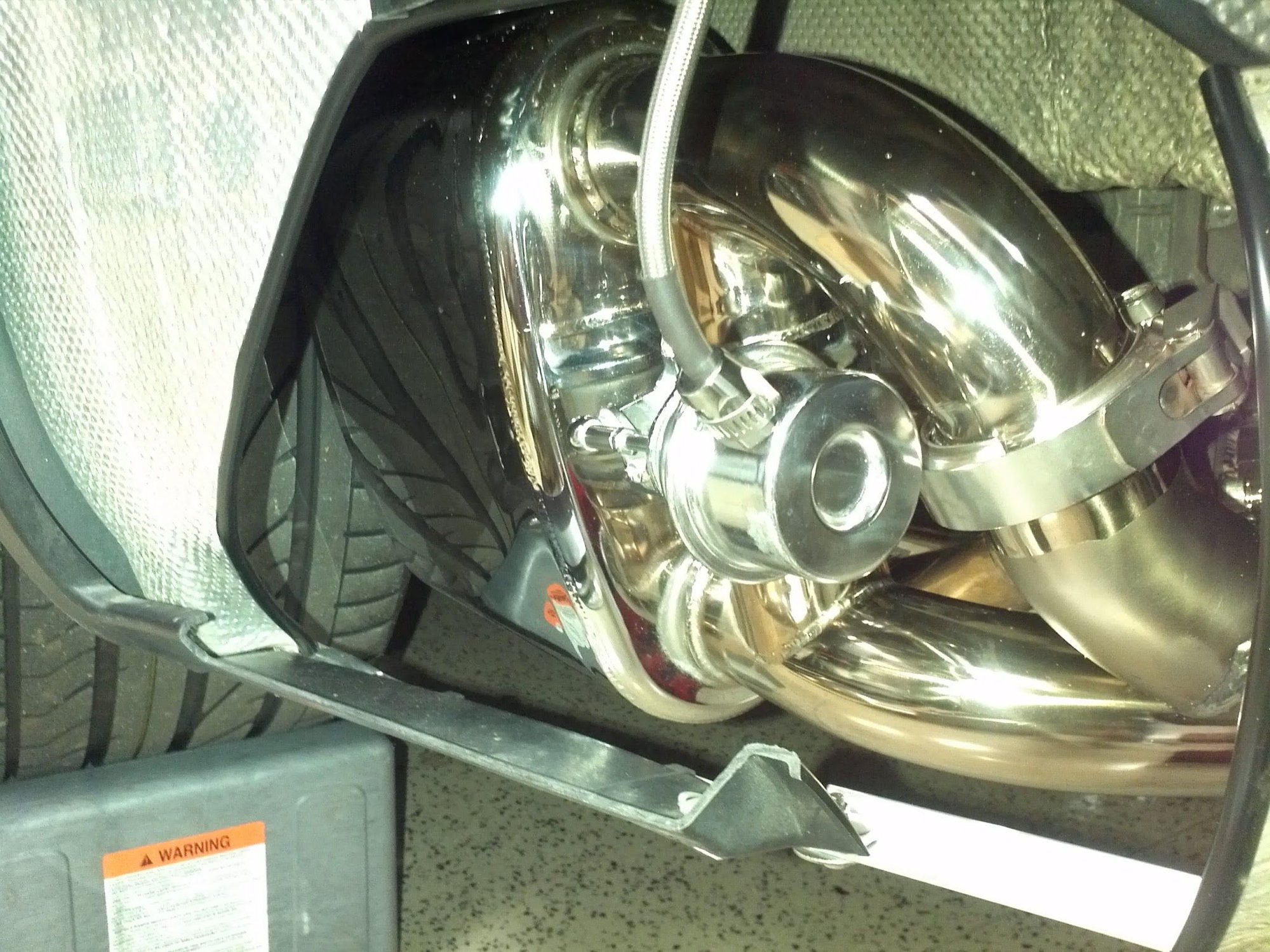

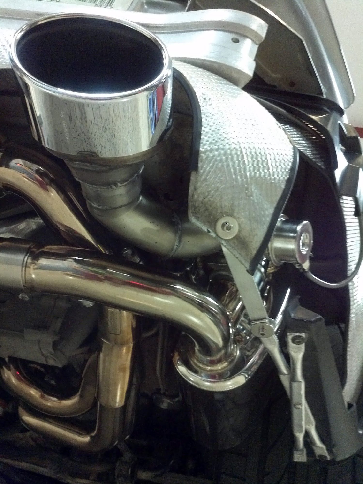

Many folks have. Attached is the official Porsche document on how to retrofit PSE into a non PSE equipped .1. Doing it in a .2 should be the same, just with different components. PSE is nice, but I love my Fabspeed setup with the headers, valvetronic mufflers, and 200 cell x-cats. Although I drive the car with the exhaust mostly in sport mode, being able to quiet it down in the neighborhood or when passing or driving next to a cop is a nice feature. It has also been said that the DME automatically closing the valves at low rpms increases torque, but I'm not sure you can feel that. If you want PSE valved functionality, but don't want to change the console switch plate and do the additional wiring, there are remote control kits for the vacuum actuator too.

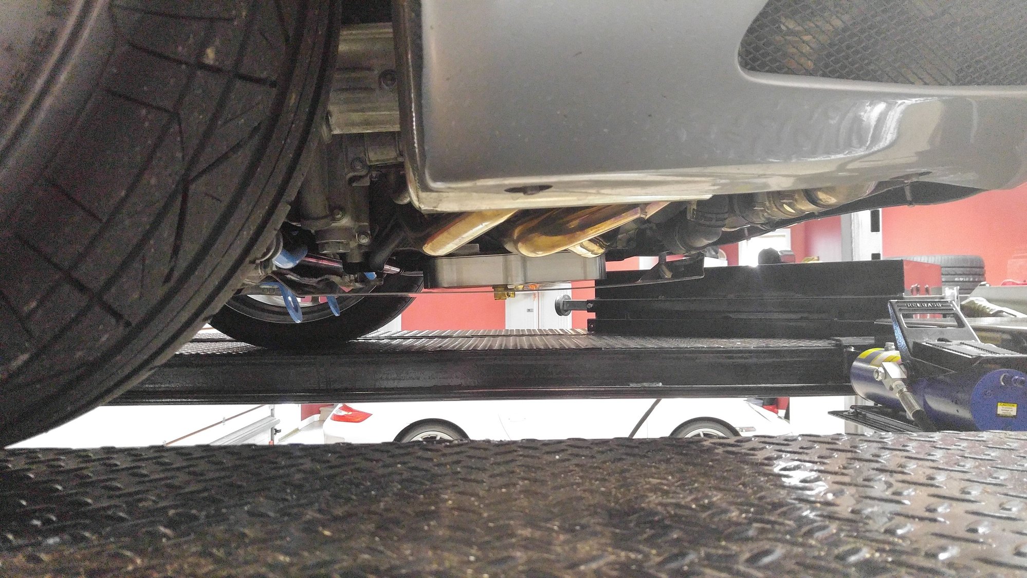

What's goin' on in that last pic with the box over the engine?

That's an LN Engineering skid plate to protect my MantisSport 2L deep sump on my lowered car. The skid plate from Porsche is kind of a joke and only works with the stock oilbpan. This LN one is much thicker, strong, and well made. You never know when a dead animal or large tire gator might be unavoidable, and I'd prefer to not lose 10 quarts of oil in 2 seconds and need a tow in the middle of a trip.
Here are a couple other views
MantisSport 2L Deep sump without skid plate
Skid plate - from rear
Skid plate - from side
