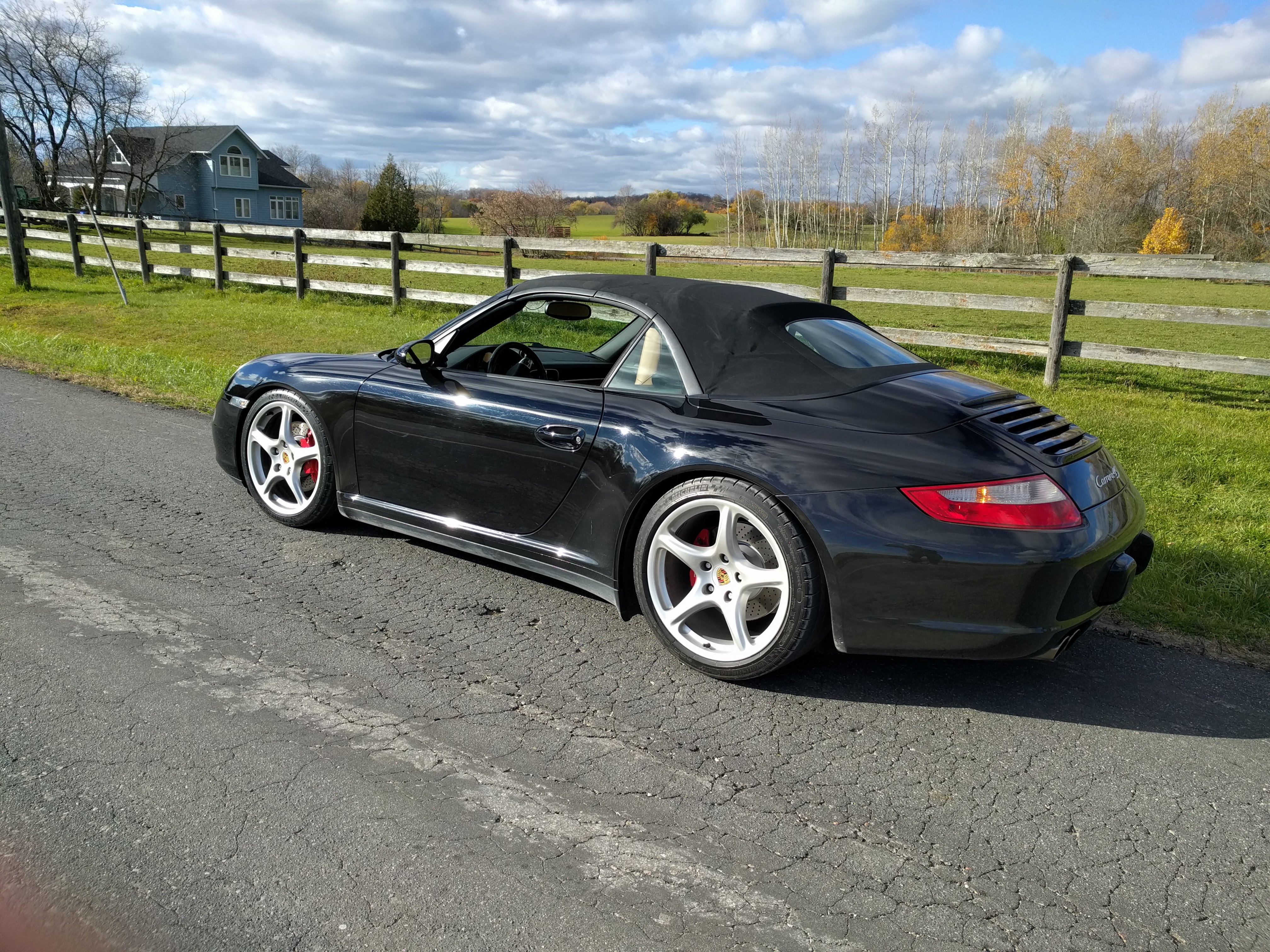

Had my 997.1 rebuilt due to bore scoring and its back. Havent posted it here before (always on RL) but thought some might find it interesting and I am excited to report on it
Picked the car up this afternoon - whooo hoo
With the cats and headers it sounds much much more aggressive. Deeper, more growly (which I am sure is not a word). I have tried to attach 2 sound files, one from inside the car windows up and one with the driver window down - not great recordings but a hint of whats going on back there. When he fired it up in the shop you should have seen my grin
Now for the driving.....my mechanic drove it for 8 hours with the break in oil and then changed it this morning to the run in oil (Joe Gibbs dino racing oil). I have to drive it for 1600kms and then the oil will be changed again.
Pulls stronger and its faster for sure which is to be expected - better be after all this . But I am not supposed to hit 5k and I wont so I don't expect to see the full potential till I can really get on it.
But so far, having a blast. No radio on this aft when I put 200km on on my way home (some slight detours given its a 20km trip). Just enjoying the sound and some pulls on the back roads!!
Wife and I going on a fall drive tomorrow to put some more kms on - will probably be back for the next oil change within a week ......
Glad to have it back in my driveway

Is the car lowered? Is this a Canadian car? Why bore scoring?
The car is lowered on H&R. The car spent most of its life in Vancouver but came originally from Seattle I think. The speedo is in mph
Why bore scoring?? Well that is the million $$ question. It appears all M97 engines are susceptible to it and its mostly the luck of the draw. Some attribute it to temps ie I live in Toronto and drive year round but then again cars that have spent their life in FLA get it. Go to Rennlist and on here and search the 997 boards and you will find all you want to know (or probably more then you want to know!! )
