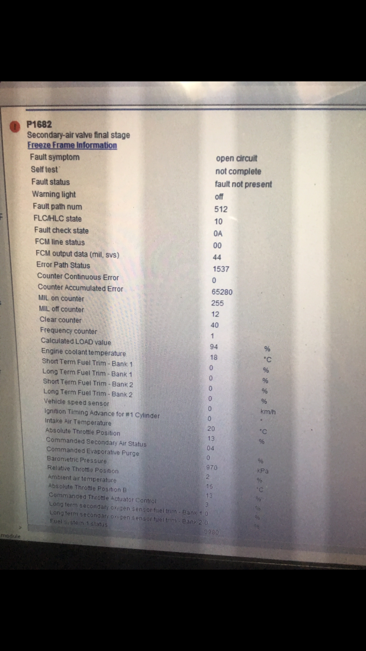

The battery was replaced 6 months ago. Before posting this thread, I did the "drive cycle" 3 times at midnight without success.
As an update, All 5 Smog items (cat efficiency, o2 sensors, heater, etc) are in Pass status as of Yesterday. And yes, Prior to yesterday, 3 items were in Fail status.
Though 5 items are passing, i still have P1682. Hope this pic/detail helps:

I had the same issue after I cleared some codes. Took 2 weeks of daily driving to clear the last stage for the air pump. I kept checking for it to clear with the Durametric after each drive.
