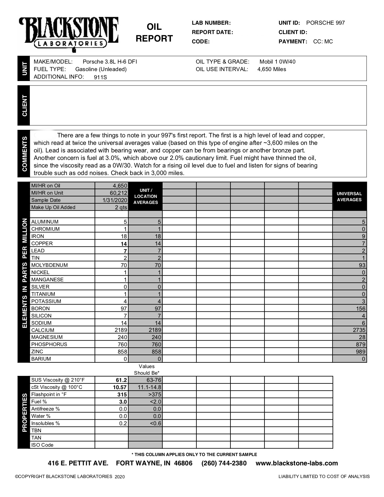

2006 911 C2S Blackstone Oil Analysis
I showed this to my mechanic and he told me not be concerned and just check the oil again at the next oil change. I can help but being concern with the results. Has anybody ever seen this before in a test?

Yea, that's not good. First thing you should do is stop using Mobil 1 0W/40 in this car and switch to either Driven DT40 or Motul xcess 8100 (both 5W/40) or if you live where it's hot year round like south Florida, driven FR50 which is a 5W/50. You need more film strength and more Zinc and Phosphorous than what you have - you want over 1,000 ppm of both in the UOA.
You need to replace all your fuel injectors. At least one is bad and diluting the oil with fuel and its causing bearing wear. This is also one of the leading causes of cylinder bore scoring in these engines too.
Smoke test the intake systems and make sure you don't have a vacuum leak that the car is adjusting fuel trims richer as that can also dump extra fuel into the cylinders.
This is exactly the reason we spend the money for UOA - so we can catch issues like this before they destroy an engine from the inside out.

Flash point is low, viscosity is low, fuel dilution is high & wear metals are high. Test again and hope it's a fluke but based on this report it doesn't look great.
