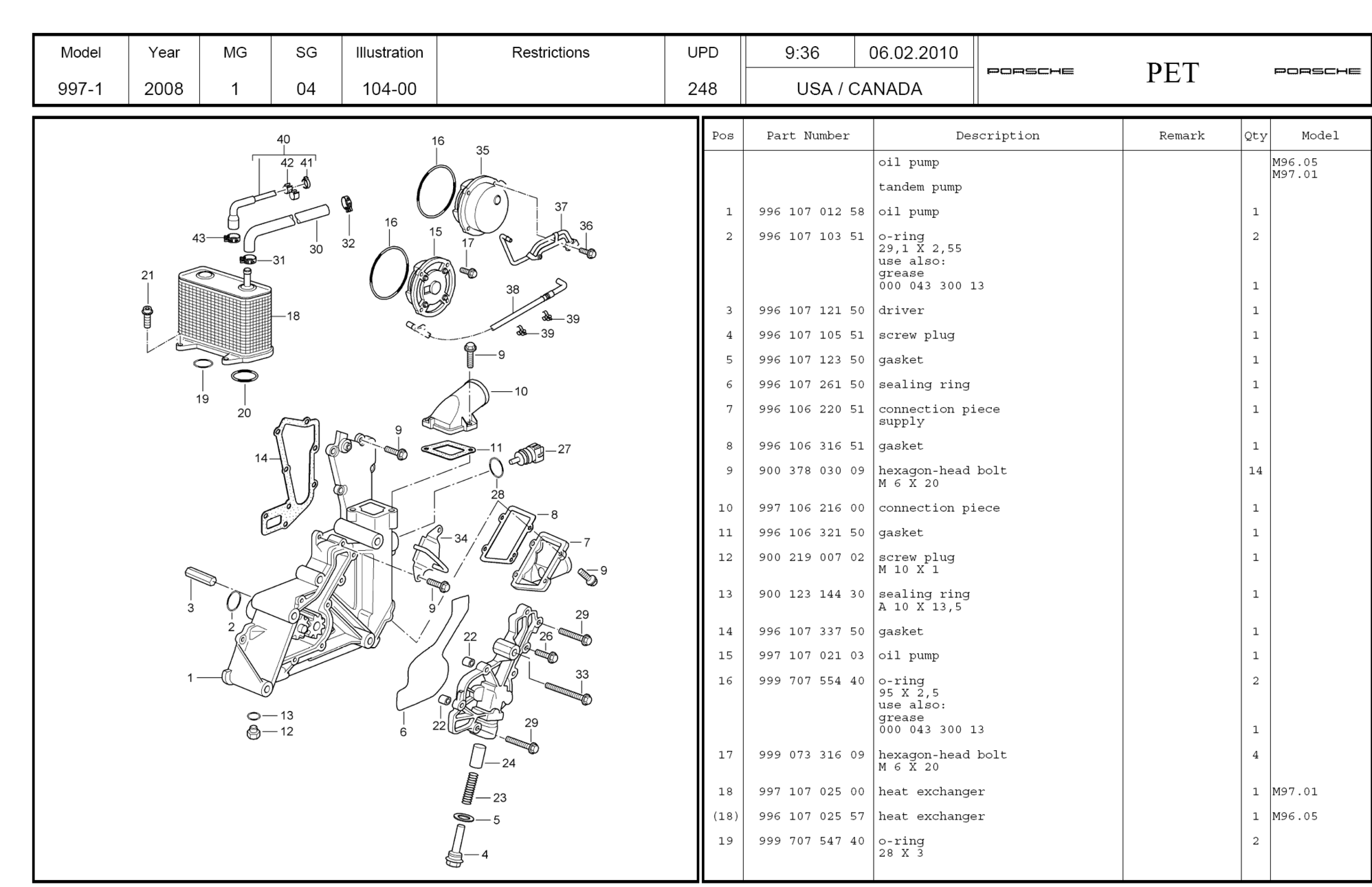

Heres an update, I sent the car in on Monday for the brake and oil filler neck problem. We replaced the oil filler neck and the hose I pictured above for the brake booster. Turns out that there's another problem, there's a hole in the hose that connects to the vacuum pump. I'm having a hard time finding the part number to that hose. The hose that connects to that hose is 997-110-055-03. Please help me find this hose (its under the car near the right exhaust).

You may mean item 37 in these pics.
Catalog courtesy of Porsche.
