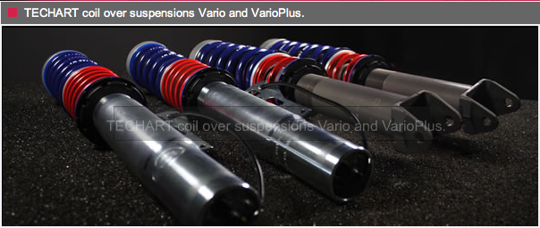

Hmmm. How do coilovers work with pasm A? Or do they replace pasm?
And how soon? Maybe I'll wait on the springs.
Old May 11, 2006 | 03:17 PM
20C4S's Avatar
Posts: 15,575
From: Los Angeles, CA
Rep Power: 682
see the wire on the tail? that should answer ur question.
i heard July but u never know.

Originally Posted by sharkster
Yeps.. I heard Bilstein is releasing a set near September too!
I'll bet Bilstein makes the TechArt kit. As with the 996 application, they allowed TechArt to resell under their name before released as a Bilstein 'PSS9' kit.
Of course I could be wrong...
