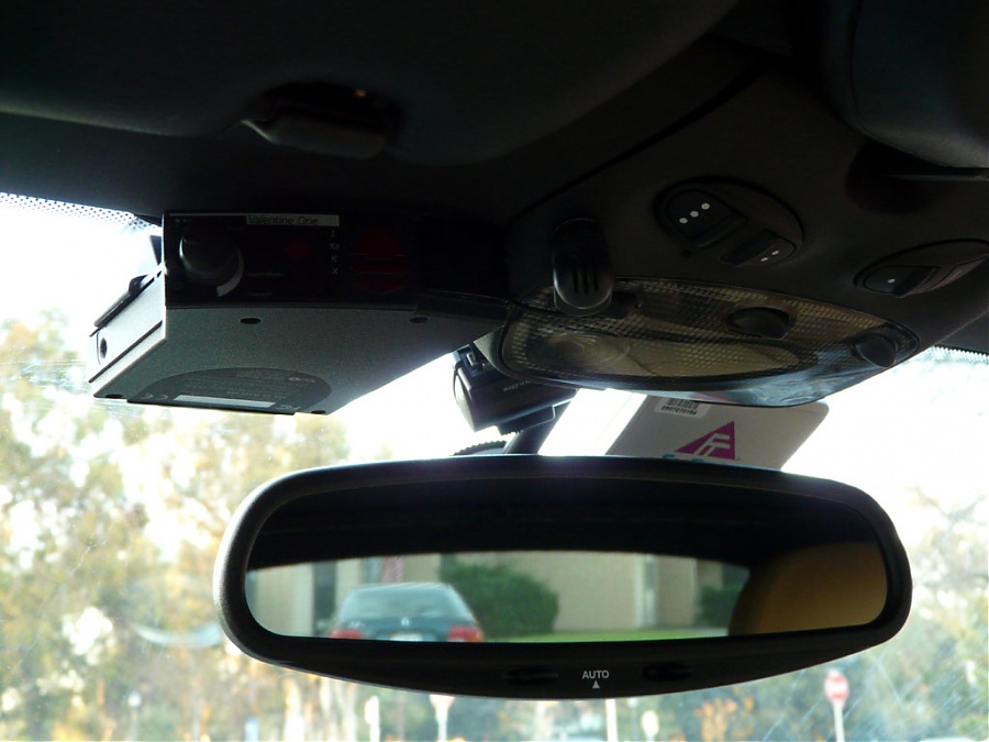

I still have mine up by the map light (see attached picture). It works well when standing still and also when driving top up (I have a 997 turbo cab).
I was hoping the OEM location would help top down, but based on your comments I think I'll leave it where it is. Thanks for the feedback!
