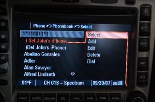

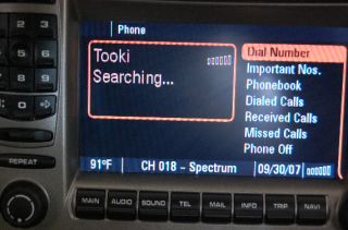

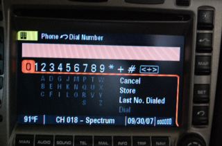

As promised, some screen shots. Note that Nav-TV's name for the Bluetooth adapter is"Tooki". It's searching because my cell carrier's signal is not very strong in my garage.

Mister PINK is infamous around these parts
So to confirm you are actually able to dial using the numbers next to the screen? where did you porsche the kit?
Thanks.
Old Sep 30, 2007 | 04:52 PM
jfr0317's Avatar
Joined: Aug 2007
Posts: 128
From: Houston
jfr0317 is infamous around these parts
Thanks.
Yes. You can directly dial using the numeric keypad on the left side of the PCM. By "porsche the kit", I assume you mean where did I purchase it (although I like the idea of porsche and purchase being synonymous). I got the adapter directly from NaV-TV after having a telephone conversation with the head of Nav-TV after an exchange of emails. He says that the final version should be released through their retail distribution outlets within a month.
