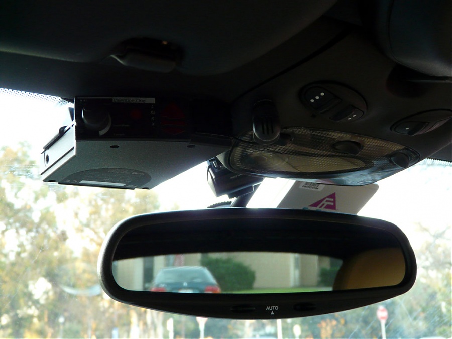

Do you guys got a pic on where you place your mic? I need to finda a good location for mine. Right now friend say i sound distant.

I can post a pic tonight. but I think any mic like this (not up against the mouth) is going to sound distant. I called my voice mail and it is a bit distance and can be noisey depending on speed. i tried 30mph and 60 and the background noise level definitely goes up as you would expect. Is it listen-able? yep.

Here's a picture of where my microphone is - by the driver-side map light on the central dome.
I've also started a discussion over at http://navtv.com/forum/index.php?topic=47.0 to see about better third-party microphones than the stock one. Specifically, the Andrea DA-350 Auto Array (see http://www.andreaelectronics.com/Buy...Desc/DA350.htm) might be a good, though expensive option ($330). Apparently it gets good results for voice recognition - see review at http://www.pocketpclife.com/issues/i...utomic001.html. Also some more discussion at http://www.mp3car.com/vbulletin/mp3c...uirements.html and other forums at mp3car.com.
