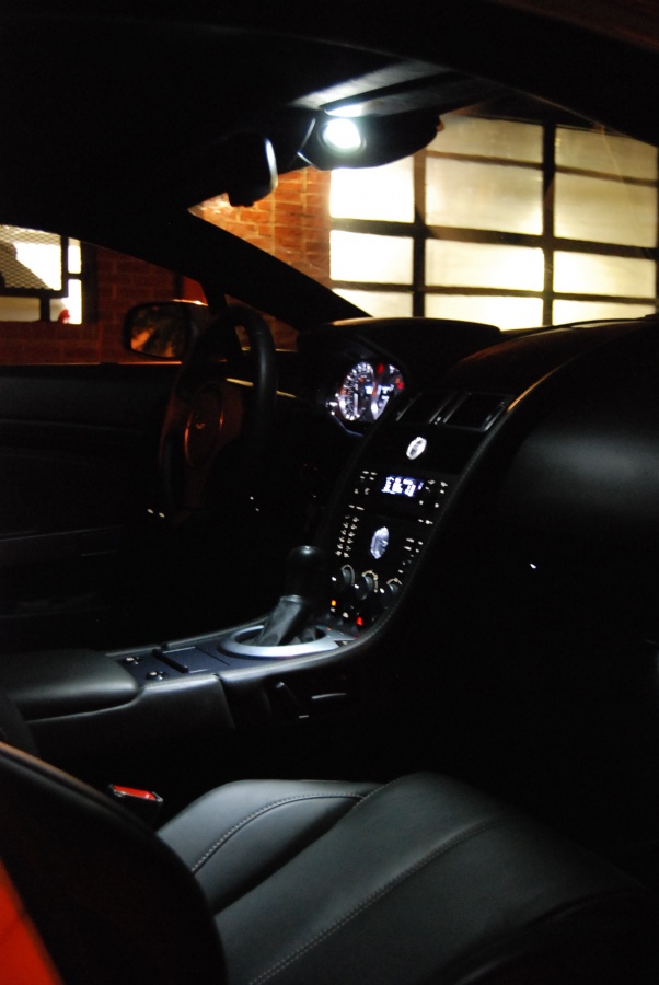

I checked out the lights tonight and I have to say that I really like them! The only thing I don't like (and I'm being picky) is that the driver's-side map light catches you in the eye a bit, and it's pretty bright. Good news is that it turns off quickly after you start the engine, and you have the independent passenger-side map light to illuminate anything you need to read (hopefully not while you're driving!).
I've attached some more pics to show everybody the results. I purposely didn't use a flash (except in one pic) so the pics are not in perfect focus. Note also that I put the camera on ISO 1600 so the lights appear a bit brighter than in reality. What I like best is how the map lights illuminate the center console. Kind of like light shining down from above on the gear shift (all that's missing are the angels singing). Thanks again Mike for sharing the part numbers.
