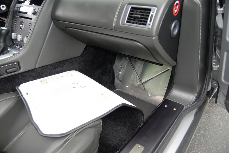

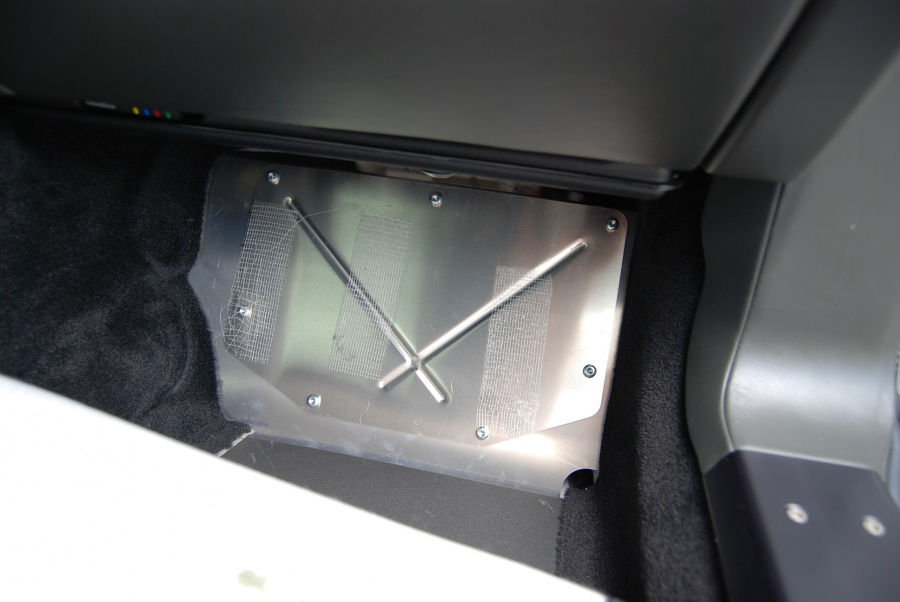

Cabin Fuse Panel
As I indicated in a previous post, the fuse panel inside the cabin is not as easy to get to as in most cars. To access it, you need to remove the passenger floor mat and pull back the carpet from the front wall of the passenger footwell. To do this, reach under the dash, grip the top edge of the carpet, and pull it down and away from the front wall. There is some double-sided tape that secures the carpet to the wall, but it is not extremely tacky. PIC 1 shows the carpet pulled back to reveal the front wall and the fuse panel cover (both in beautiful aluminum), as well as the three strips of double-sided tape that are used to hold the carpet in place.

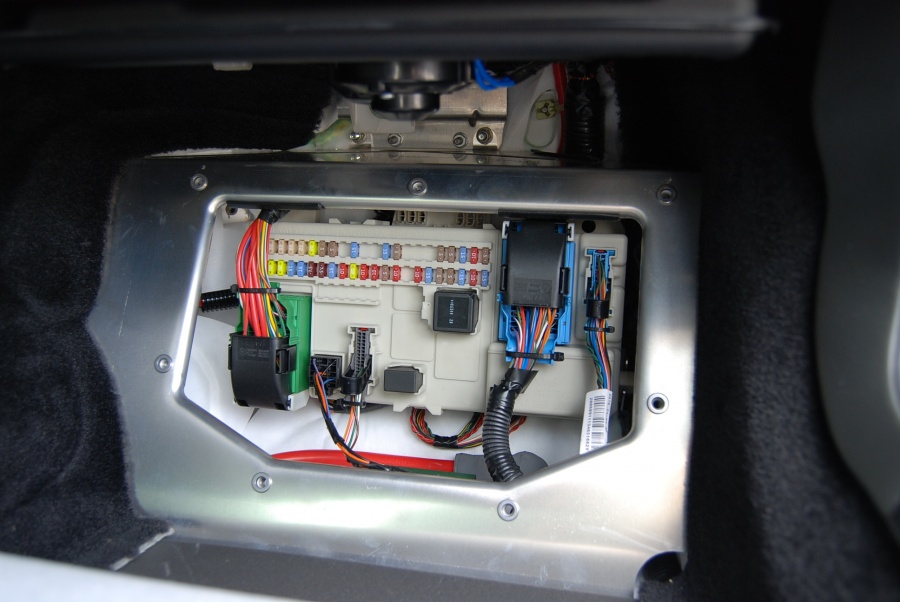

Once the carpet has been pulled back, you will see that the fuse panel cover has seven TORX-head screws that keep it in place. The cover and screws are shown in PIC 2. The heads of the screws are size T30.
After the fuse panel cover has been removed, you will gain access a compartment that houses the fuse panel (PIC 3). There are many fuses in there and the labels are a bit difficult to read due to the location of the panel. I needed to change fuse 47, which is linked to the cabin lights, trunk lights, garage door opener buttons, and the seat controls. That fuse is located in the lower row, fifth from the right. The fuse contacts are the type with pointed tips (PIC 4), not rectangular tips.
The standard fuse puller tool that one normally uses to pull auto fuses was too fat to get a grip on the fuse. Since I was far from my toolbox, I improvised by using two flat-head screwdrivers to pinch and pull the fuse (being careful to only touch plastic with the screwdriver tips). I replaced the fuse and made sure the lights/seats worked, and then pulled it back out to avoid blowing the fuse again while I changed the light bulbs.

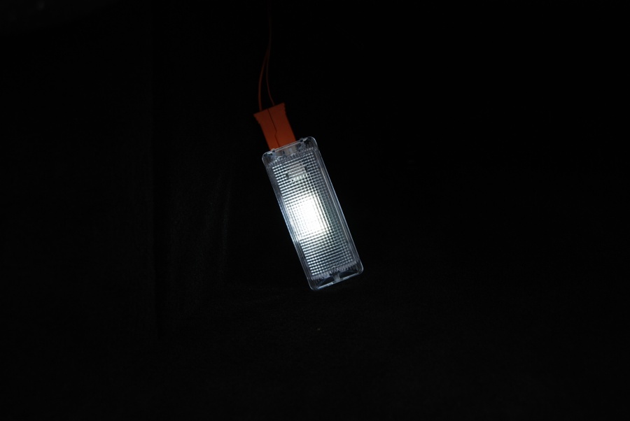

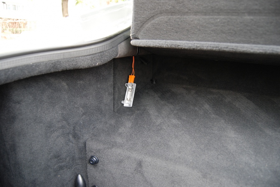

Trunk Lights
By far, the easiest bulbs to change were those in the trunk. The lights are located near the left and right side walls of the trunk under the carpeted cover that lies beneath the trunk lid. To replace the bulbs, you need to pull the light housings from the trunk trim. To do this, place the tip of a flat head screwdriver into the slot at the proximal (i.e., nearest to you) end of the housing and pry the housing downward (PIC 5). When you do this, the housing will drop down on the trunk ledge (PIC 6).
You can remove the standard festoon bulbs by pulling down on the proximal contact with the tip of your flat-head screwdriver. This will free the bulb from the housing so you can pull it out. The replacement bulbs have a circuit board with various electronics on one side and six rectangular LEDs on the other side (PIC 7). When you place the bulbs into the housings, make sure that the LEDs face away from you (PIC 8) so that they will face inward into the trunk once the housings are replaced.
PIC 9 shows the brightness/hue of these bulbs. The bulbs are of the “cool white” variety (the only color available from superbrightleds.com). I haven’t seen them at night yet, but they are much brighter than stock and provide a more modern look IMO.
After the bulbs are in place, you can replace the light housings by backing in the distal end first, and snapping the proximal end back in place.

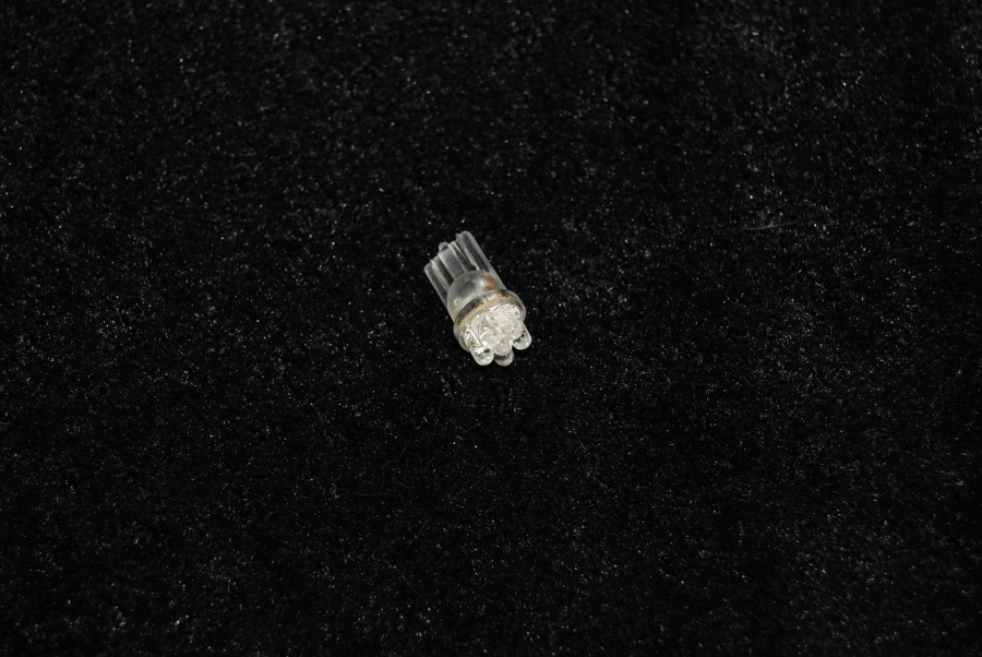

Footwell Lights
The next bulbs to tackle were the footwell bulbs. These were a bit more difficult to access, but I was able to change them without too much trouble. I have no pics for this procedure because the footwell lights are located under the dash near the center console -- I just couldn’t get my camera up there.
The bulbs for the footwells (and map lights) are of the straight press-in, pull-out type. PIC 10 shows one of the replacement LED bulbs. The driver- and passenger-side bulbs each sit within a housing that is similar to the housings in the trunk. For the footwell lights, however, the bulbs are inserted into a fixture that seats within the housing. The fixture is directly inserted into the rear of the housing (from the top down) and locks in place within the housing with a bayonet-type fit.
To remove the fixture from either light housing, you need to reach up under the dash above the housing, grip the fixture with your fingers, twist the fixture by about a 1/8-1/4 turn, and pull the fixture out of/up from the housing. I found that the easiest way to get a grip on the fixture was to lie facing upward with my back on the seat and my a$$ hanging out of the car. You won’t be able to see what you’re doing very well, but just grip the piece sticking up from the light housing and start gently twisting it and you will feel the fixture loosen.
To replace the bulb, just pull the original bulb out of the socket of the fixture and stick the new bulb in the socket. You can then replace the fixture by inserting it into its housing and twisting the fixture to lock it in place.
