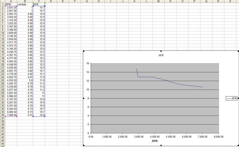

I have been thinking about this even more, our Dynojet only measures to 10:1 AFR and looking at the base run again I am sure the car was running richer than 10:1 from 5500 to 7000rpm. This is a serious issue; even in Hi Compression NA motors AFR's that rich will cause long term issues with the health of the car. The O2 sensors will live a very short life and worse yet the fuel will wash down the cylinder walls and cause premature wear of the rings. Other issues are diluted oil and premature bearing wear. I am not saying this is going to happen to every car running in the 10:1 AFR range but it is very possible.

Apparently it's "normal" in the sense that it's the stock tune. ESX said they are all like this...they run very rich. It certainly supports RSC's statement that AM left a lot of HP on the table, whether it was to not get too close to the DB9's output or to just be conservative. Whatever the case, even without a SC kit there's a lot of HP to be gained from a proper tune and it sounds like longevity would be improved as well.

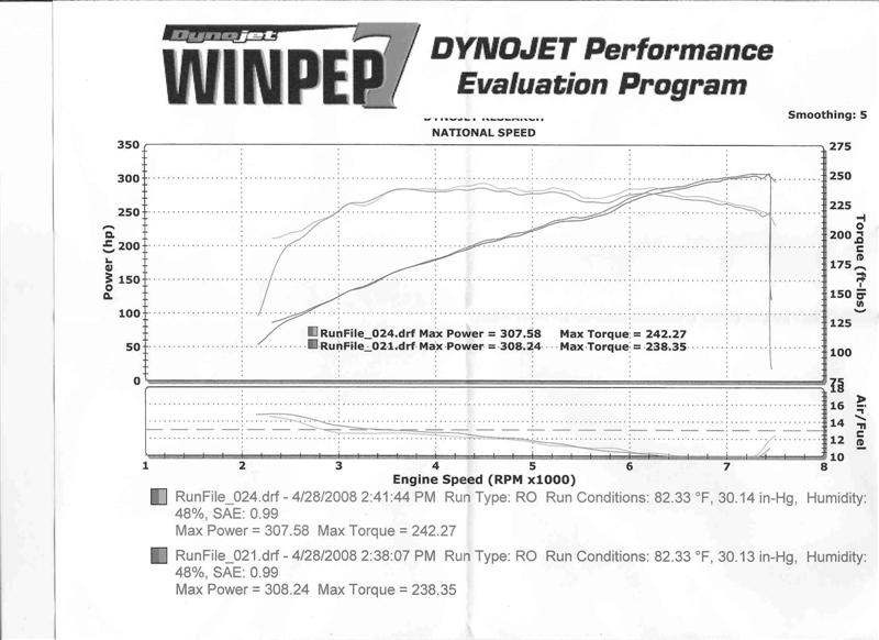

Here is my stock dyno. Also rich!.
ECU is typical Motorola mpc565 processor but a BDM module does not connect to the Aston Martin board. A custom solution has not yet been developed(which pins and how to talk to to them). Great job for an ECU hacker.

I think you're speaking a lot of sense. We've certainly found that the AMV8 produces larger than usual gains on a NA remap, but more interesting is your comment on O2 sensors. I've now seen and heard of a number of cars that are killing O2 sensors in similar sorts of mileages to the clutches (around 15,000). We actually lost nearly 2 days of time when we were mapping the RSC supercharger on the rolling road because of a misfire eventually traced to a faulty O2 sensor.
Funny that the assumption typically is that the OE map is the safest and the aftermarket ones are stressing the engine! Not always the case!!!
