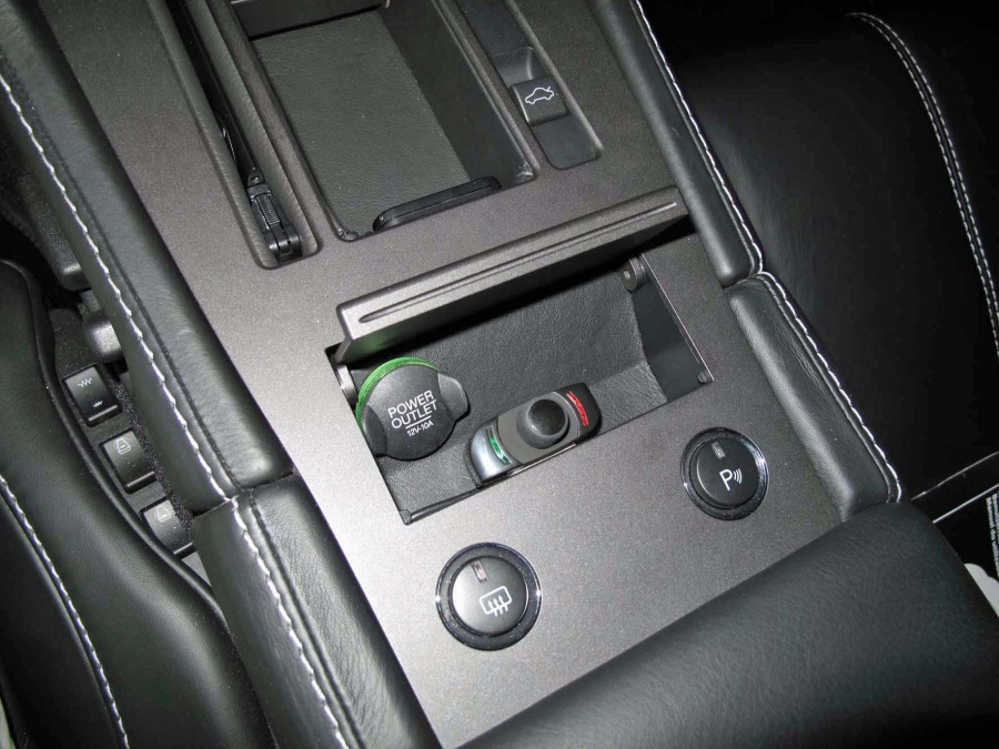

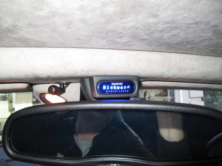

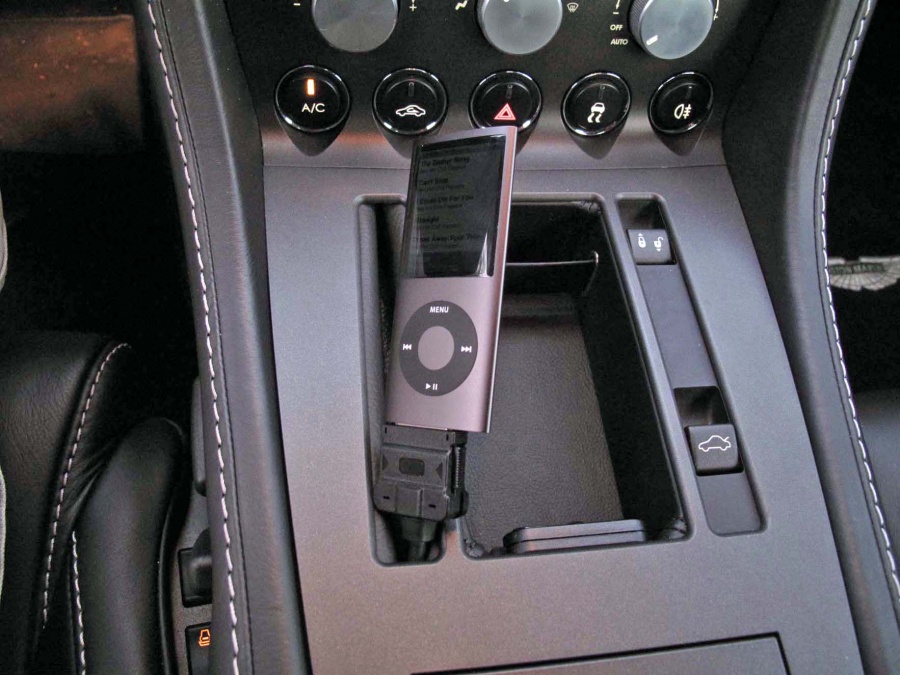

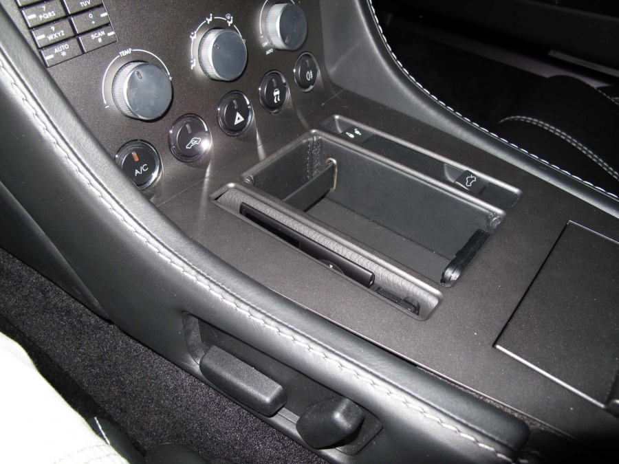

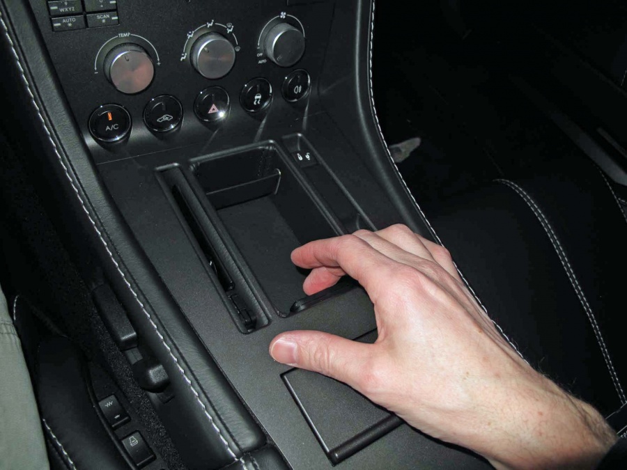

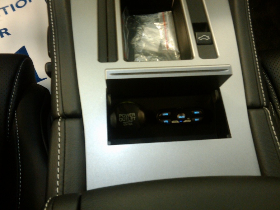

Benchmark motoring in Bellevue did the work, happy with how everything turned out. The whole fiber optic BS that AM uses really keeps the third parties from getting to do much.... annoying. The radar detector and bluetooth work very well, the ipod has to be toggled with a switch. It takes 5-7 seconds for the ipod to kick in... a bit annoying, but it sounds way better than the radio and I love how they placed the ipod! Too cool. They had to pull the whole coin thing and make a new holder, looks awesome.
The radar detector controls are in a spot where I can rest my hand and hit the mute button if necessary. They made an enclosure for the display, same texture as the OEM cap for the mirror base.

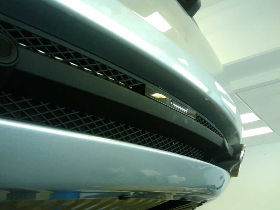

Very nice! Is it front and rear detection and if so, where did they mount the rear sensor? Any pics of that?

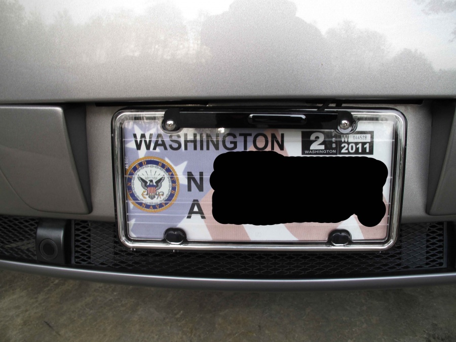

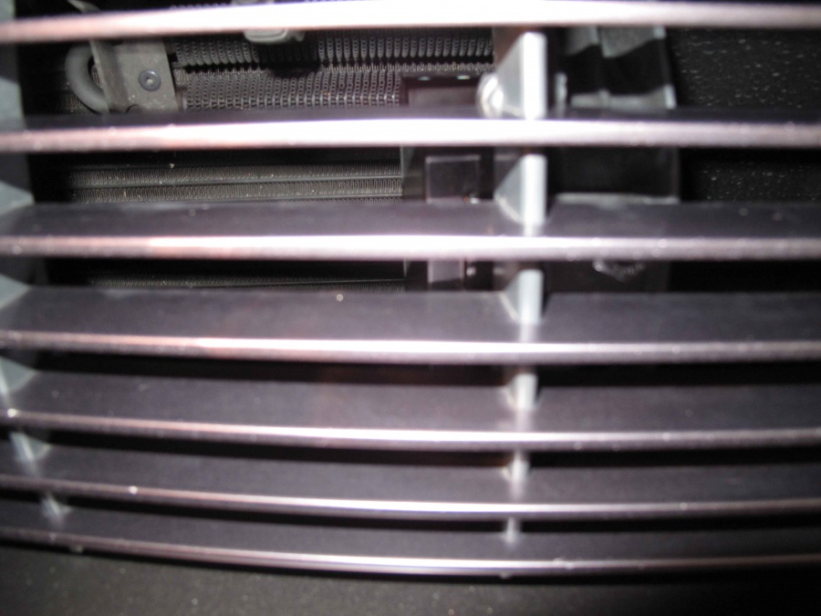

It jams from behind, they mounted it on the license plate. There are two jammers in the in the grill in the front. They fabricated brackets for everything...ie no holes were drilled.
If you mean detects from the rear, I'm assuming yes, but can't confirm.

Hi, I'll try to post some pics soon. The rear jammer is on the license plate frame, fairly obvious. The front two are hidden in the grill. The electronics fit under the footwell on the drivers side. I think you could mount the rear one down lower by the diffuser and hide it better.
Yup, the cops are getting serious, my wife got a ticket on I-90 two nights ago, for...are you ready....65mph. Unbelievable.
here are the pics

$2700 plus taxes for the 9500ci installed. I like where you got the control unit installed so it's easily accessible but not obvious when you look in the car. I have a Roadster so the display unit might be just a bit too obvious above the rear view mirror for me so I'll have to figure something out for that. The front sensors look nice and hidden but the rear sensor is a bit too obvious for the cop behind especially when the first thing they do is look at your rear license place. I wonder why the rear sensors couldn't be hidden behind the mesh grill under the license plate. I was thinking of having it mounted to the mesh grill just beneath the license place. This makes it bit more tucked behind and maybe a little bit less obvious when you are looking at the plate from a standing angle.

thats about what I paid for the install, but it counted the custom enclosure for the display. I don't think it would be too much even with the convertible, it is only about an inch more forward than the base. I saw that other people mounted it pointing at the driver on the base of the mirror.
The argument I got for mounting the sensor on the license plate, was that the cops aim at the plates. It would look better lower, but not sure it would be as effective.

The radar antenna can be mounted behind the grill, but the jammer heads need to be mounted with a clear view of sight to the front of the car. If you mount them behind the grill, you significantly reduce their ability to jam a LIDAR gun. Of course if you're just running them in detection mode, then it doesn't matter as much.
I speak from experience with the jammer heads of a 9500ci installed in my BMW. At first I had them behind a grill and had a police friend try to clock me with a ProLaser III. Got a reading everytime. Moved them so they had a clear view of the road ahead and got about 80% jam. Made sure they weren't towing in or out, and made sure they were level, and it jammed 100% of the time on multiple runs.
