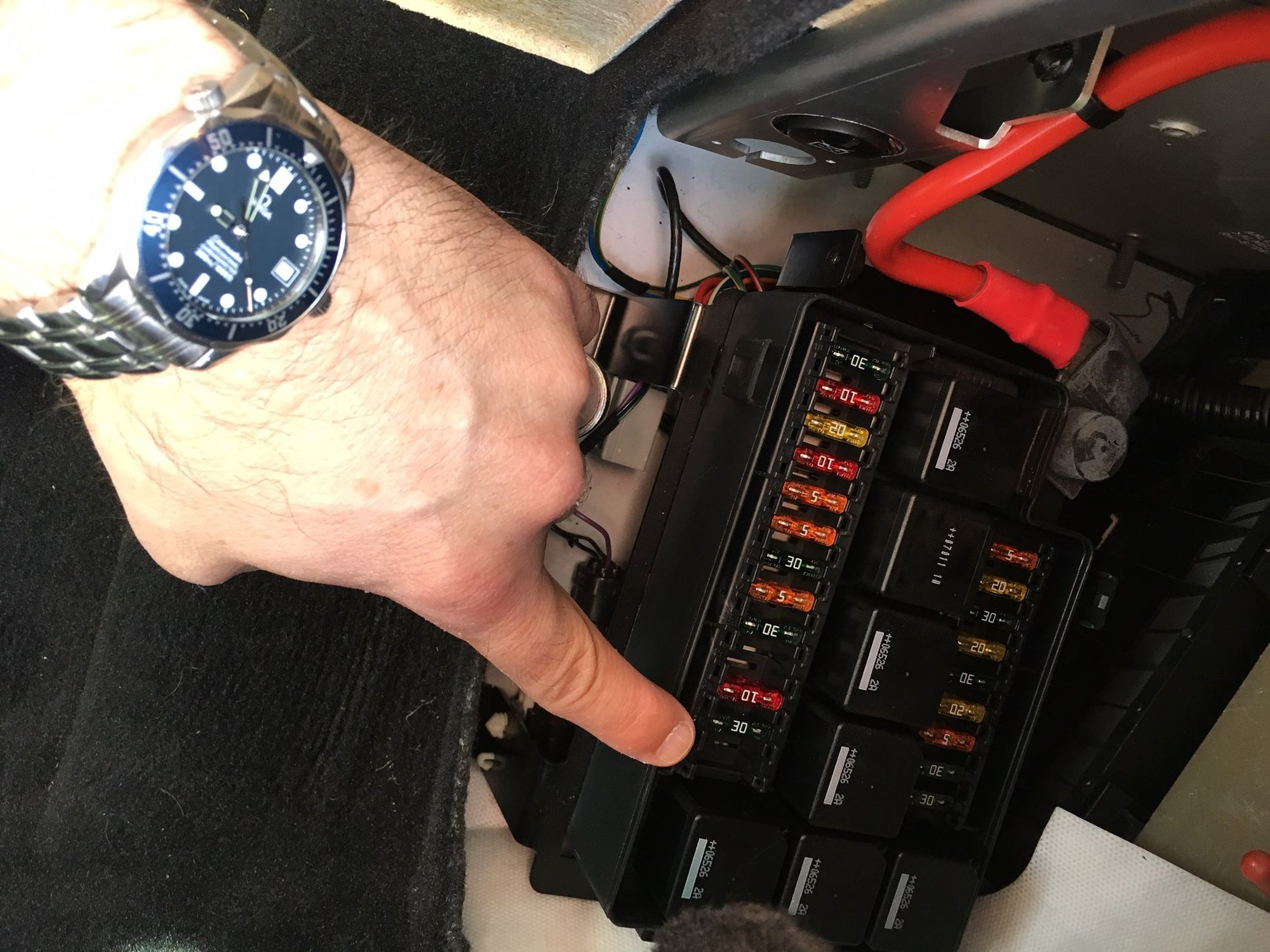

On my 2007 Vantage. Note there are tiny, tiny fuse location numbers molded into the black plastic housing alongside each fuse.
nice watch, i'm quite fond of mine as well
