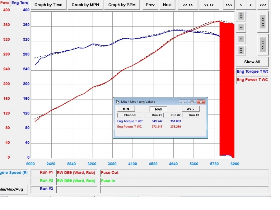

Couldn’t find anyone who had done this already, so for ****s and giggles I did it myself.
The result? 2 BHP and 2 Torques less with the fuse OUT.
I’ll let the debate begin as to whether that’s statistically significant, either to physics or the seat of the pants, but to me that falls within the variability of the dyno and makes no difference.
I was going to do 2 runs each which might have narrowed the gap a little, but in all honesty hearing the engine screaming at full chat scared me a little and I bottled out of the second set. I didn’t want to see pieces of engine flying out of the bonnet.
Car is a stock 07 DB9 Volante, 22,000 miles.
Not sure what losses to apportion to the drivetrain, but the averages were 350 torques and 375BHP at the wheels.

Should point out that on the graph the solid line is Fuse OUT, dotted line is Fuse IN.

You can apportion about 15% loss to the drive train, so if you are measuring 375BHP at the rear wheels, the engine is putting out about 440HP.
Also, I think your conclusions are right, the small difference is due to variability. The reason I say that is that in both situations, fuse in or fuse out, the valve is fully open at Max HP.

Actually you make a good point, in that the debate is really around low end torque, not top end.
In which case I may have just added fuel to the fire – bugger! The curves for each are identical all the way up, but the torque at 2000rpm does seem to be coming in higher with the fuse in (dotted line)....
Don’t know enough about dyno’s to comment on that.
I’ll ask them tomorrow.

Actually I'm a complete idiot, aren't I? I need to get comparisons lower down the range, say 1500 - 3000rpm. I'll go do it again...

This is definitely just dyno variance, it is not statistically significant enough of a difference. Just to put a precise number on it. 2HP/TQ comes out to .005 or 0.5% difference, which definitely in the category of inter-dyno variablity.
Keep in mind, that's on a DB9, not a V8 Vantage so the results may be more significant on a smaller displacement higher revving V8V. But I wouldn't be surprised if the results are the same. It appears the psychological effect of the noise alters the brains perception when in reality makes no real difference at all (basically its all in our heads).
The only way to really make significant difference is to alter the actual exhaust route (aka putting a new exhaust on). Even then from what I've seen, the differences aren't that big up top, but there are gains in torque to be had from 2500-4000. This is siimply because there are not two exhaust ways, but rather one better freer flowing single exhaust path. Backpressure shouldn't be an issue with those cats & etc. That's where the staggering majority of your backpressure is going to be found. Now if you deleted cats all together ... then torque loss would be a serious issue probably, but otherwise these motors don't appear to need a whole bunch to do the job quite well.
FYI, that's a mustang loading dyno so the drivetrain loss is actually higher, its probably closer to 17%-18% than 15%. those are strong numbers.

OP Also, if there was any difference it would be under 4k RPM as some others were saying. The way to really see if there were any differences would be to do 3 pulls with the fuse in and 3 with it out. I would imagine you MAY see a VERY slight loss in low end torque with the fuse out but if this were even so, it would be negligible.
