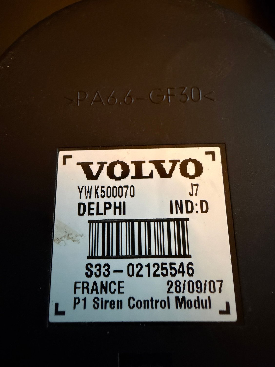

I purchased a '06 Aston Martin DB9 back in '06 and made it until '21 before "Alarm System Service Required" appeared on the cluster. At that point I did much research and discovered that the Volvo YWK500050 high spec alarm's battery had died. I then discovered that it was no longer produced and the replacement was Volvo YWK500070 which I then purchased and installed without issue and the warning light went out. Fast forward to '26 and the "Alarm System Service Required" light is back on, I dissected this alarm hoping to replace the battery or get some advice on what the current high spec alarm would work, attached are pictures of battery if anyone knows where to source this that would be appreciated if not where to get a new one?

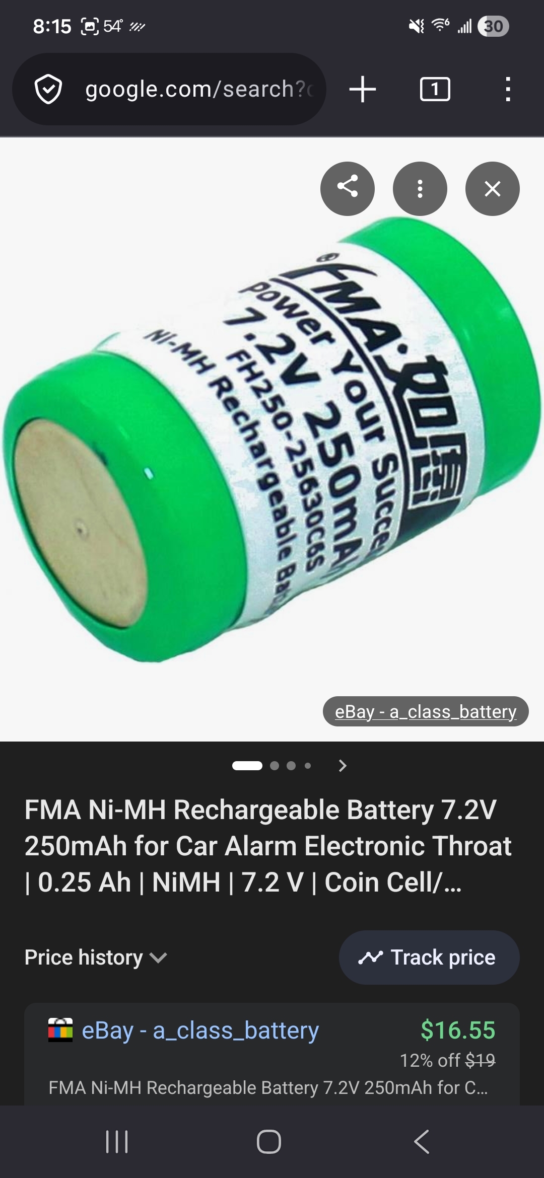

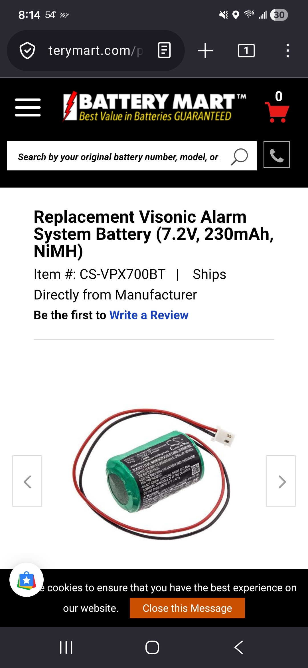

Just match the spec on the original. If you happen to have a batteries plus store close by, they could help you out.
ID:	545343   Click image for larger version

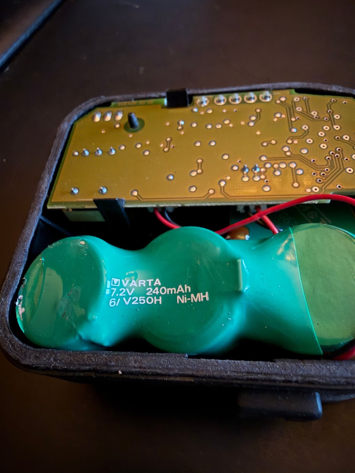

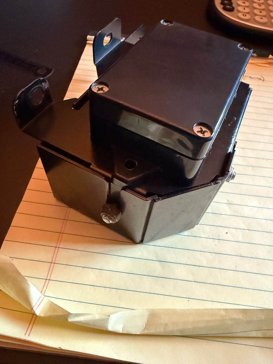

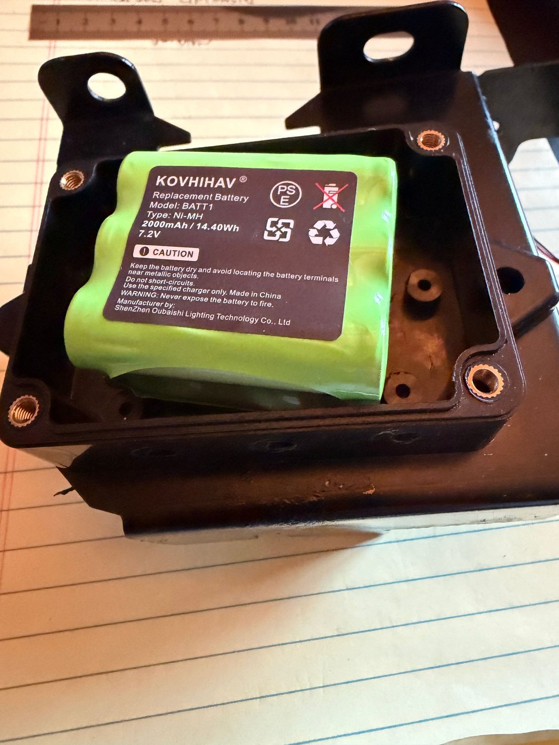

alarm update
remove tab for original batteries
purchased amazon 7.2v 2000mah ni-mh Battery Pack less tya $20
purchased amazon 7.2v 2000mah ni-mh Battery Pack less than $20
mount back of alarm to alarm case securing watertight box
amazon box (battery inside) mounted to side of alarm box
amazon box (battery inside) mounted to side of alarm box ABS Plastic Electrical Boxes Electronic Enclosure Black 3.94 x 2.68 x 1.97 inch
I ended up purchasing thru amazon the correct battery after reading specs on old battery and a watertight box. I first tried everything before spending a couple of hours fabricating this box. Decided to remove the battery from any damageable electronics in the future. Make sure to drill breather holes in box, I wouldn't be surprised if the reason the old batteries corroded was lack of ventilation. After two or three starts the system recognized the repaired alarm and warning on dash went away and alarm works well after function testing. Please reach out with and questions.....
