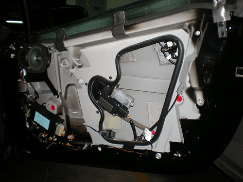

Did some buzz/rattle investigation on my premium audio. Here are some pictures that irish07 was referring to.
Per point #2 of his post. The backside of the grille, which is not shown cos of the foam. I added some neoprene tape all around.
Per point #3 of his post. Foam surrounds, torx-head screws exposed.
Removing the panel wasn't as bad as I thought!
