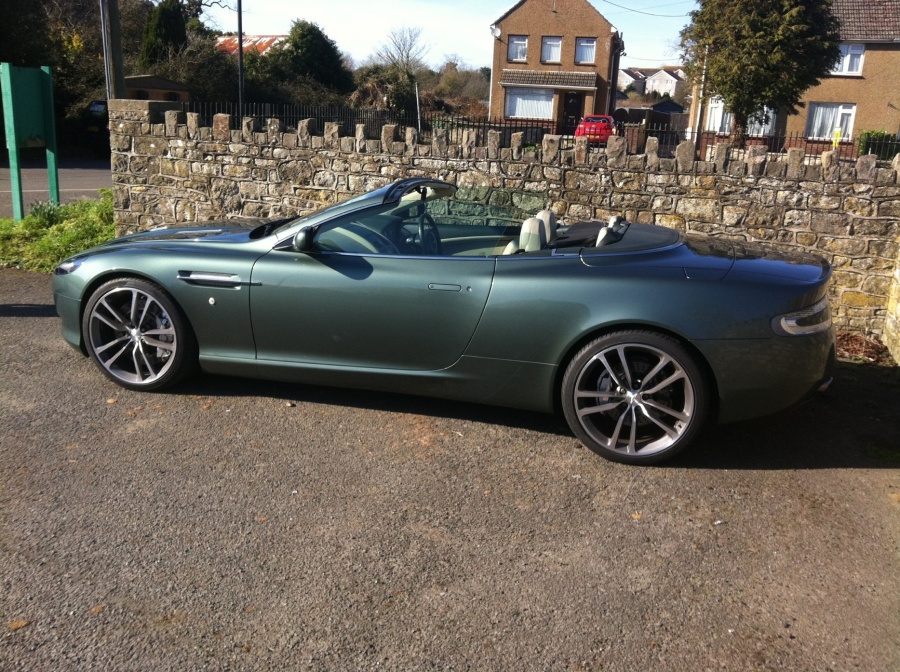

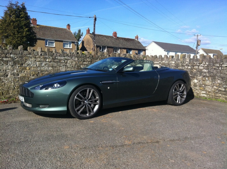

Pictures in the sunshine today with DBS wheels.
