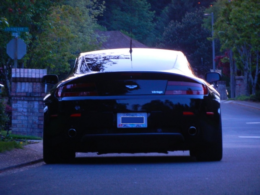

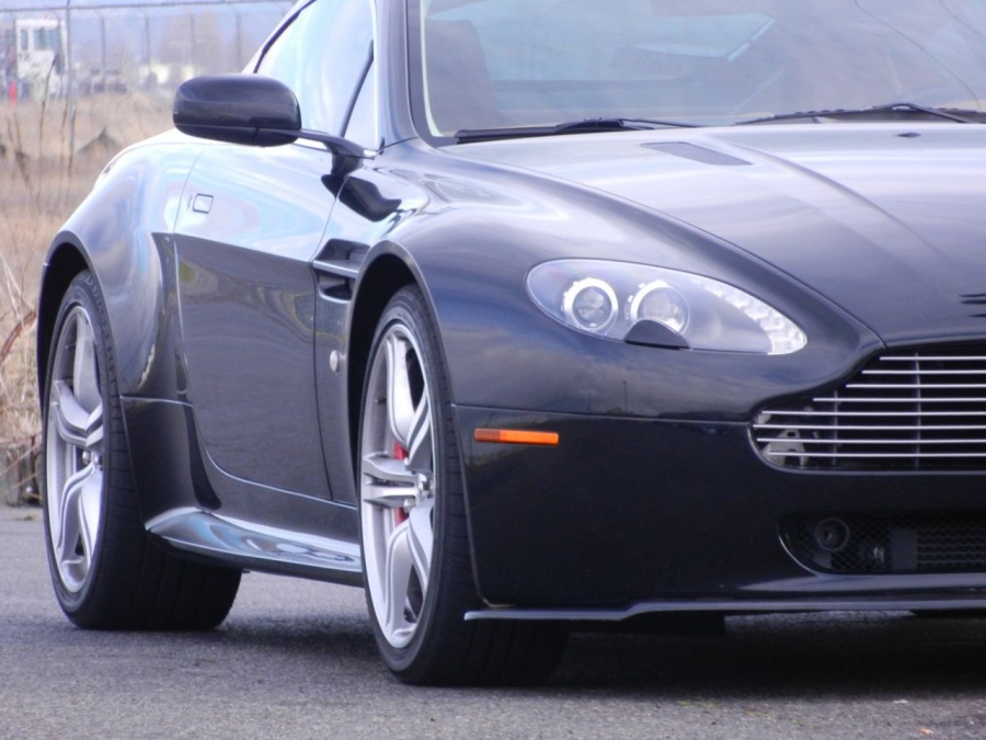

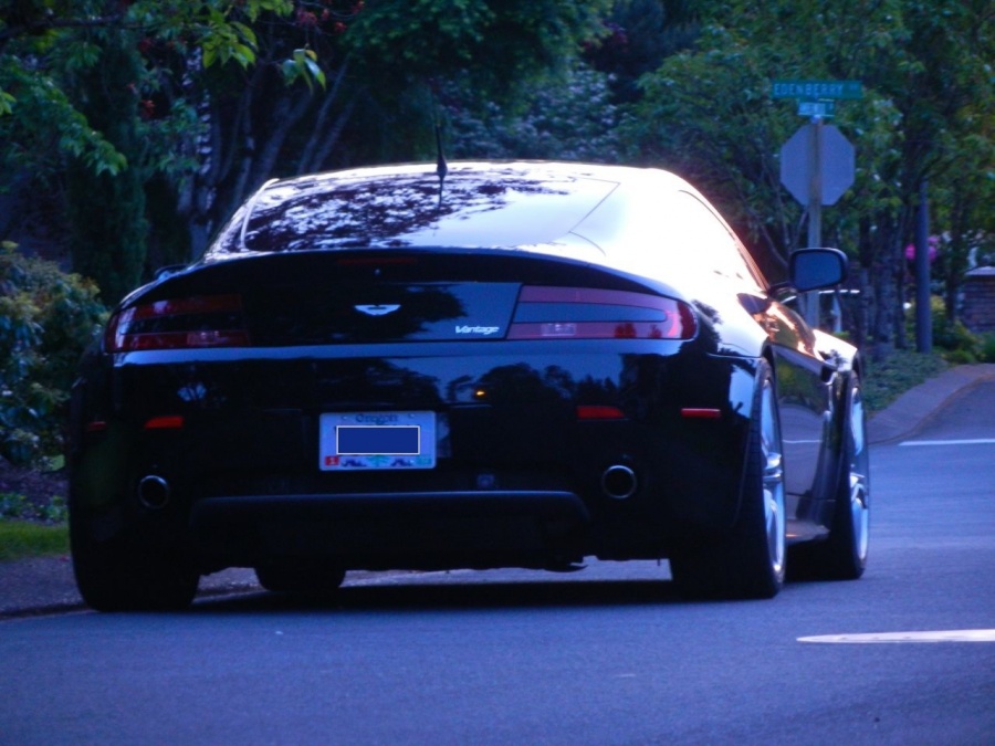

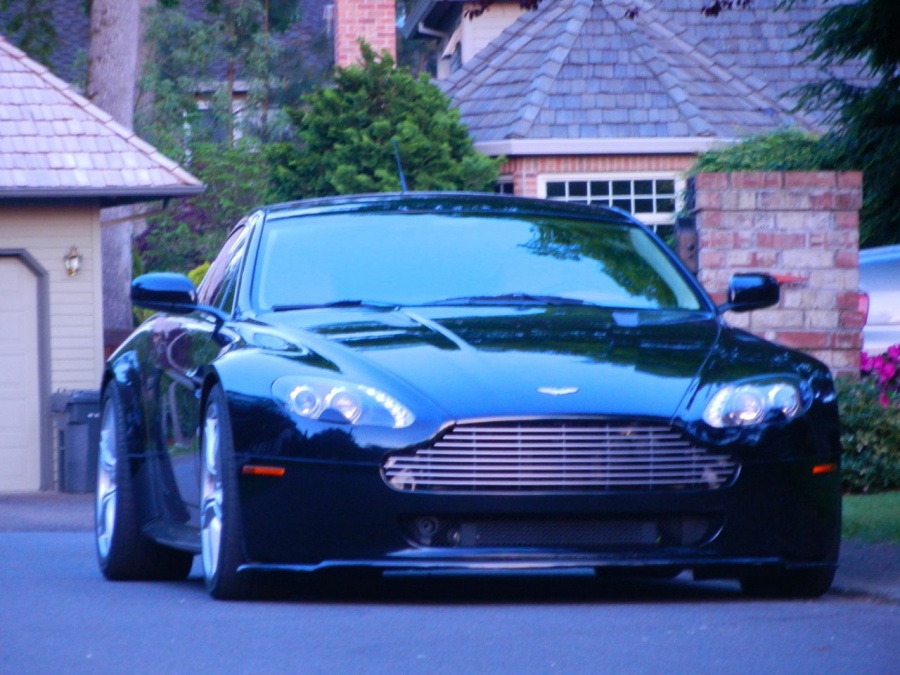

Here are some before/after snaps. The spacers are RSC, and the springs are H&R, sold to me by Stuart @RSC. They're around a 15mm drop, not the 1.25" drop. I like the look.

more

last two.

Looks good, not too extreme and how I would have preferred mine to turn out. Did RSC change their springs, then?? Because that is not the drop I got...

Purely subjectively, the lowering springs on my car were a noticeable improvement in all areas. Speedbumps ("sleeping policemen" for you lurking pistonheads guys) are less jarring, road imperfections generally have less crash to them, and the car has less roll especially on the quick changes of direction. And yes, it was pretty flat to start with. Steering is now little sharper, too. Of course, keep in mind the placebo effect of doing anything to your car you hope will improve it. "Ah yes—much better now!"
I got this done in conjunction with the RSC spacers, so keep that in mind. And you must get a geometry done when you get the goodies installed. Unsprung weight is reduced around a pound per spring. And if you'll notice that, I have this beautiful property for you....
You may notice a splitter on my car. That was provided my RSC, too. The fit and the finish on it couldn't be better. Well, the finish could be a little better now.
Hey, it's a car, not a museum piece!

I asked the shop to measure pre/post drop, and they did. They measured from the top of the wheel arch to the tire, and while the exact measurements are away from me at the moment, I recall seeing the average drop to be in the 5/8"-3/4" range.

So I'm still confused. What's the final consensus? Are there two different sets of springs with two different drops available? Looking at the pictures, I think Spinecho's drop is way too much—especially in the back. This is the usual drop amount I have seen in every picture of a Vantage with lowering springs and I think it looks awkward because the rear tire actually tucks in under the fender lip.
Sonnyd's pictures, on the other hand look perfect to me. If I could get a stance like that from springs and spacers, I would seriously consider doing that to my car.

Well, you should be confused. To make matters worse, the part numbers on the H&R springs are the same whether you get the 1.25" drop or the 5/8" drop. I found this out between receiving the springs and having them installed, and asked Stuart @RSC to confirm for me that the springs he sent were the lesser of the two ride heights, er, make that greater of the two ride heights. He said they were, and by golly, he was right!
But K-FM et al, Stuart is in the spring supply biz (among others), and I'm certain he can get you what you want. You could ask for the "SonnyD drop", although that sounds more like what I do after breakfast each day than something you'd want to install on your car.
Lowering springs—less is more. No, really!
