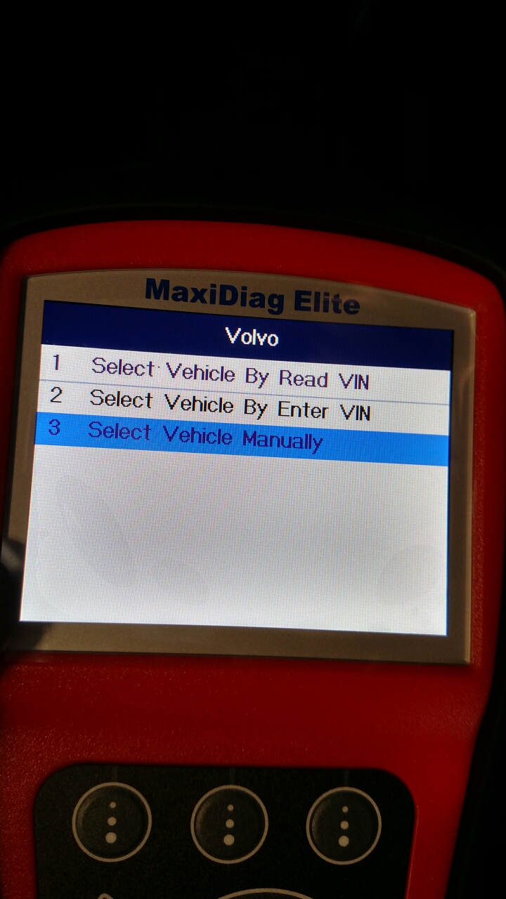

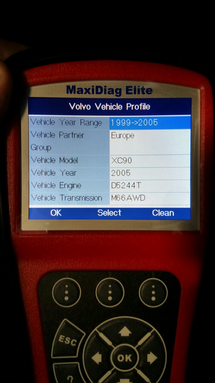

Sorry for reviving such an old thread but I've been searching through looking for a post that can hopefully answer some questions for me with not much luck.
Hoping someone can help me with the settings on this. I'm sure it's pretty basic if you have some experience with this.. But I'm really clueless.
I tried entering the vehicle information manually as obviously 2005 Aston Martin DB9 isn't an option.
Using the Volvo XC90 as my vehicle I have tried several different combinations of model years, engine, transmission etc. As you can see in the photo it's also asking for location, etc.
Can someone please help advice me on what settings I should be trying? I have a feeling that maybe I'm missing something pretty basic here..? It keeps saying that it can't connect because incorrect vehicle information, low battery as well as some other things I have ruled out.
Any help would be greatly appreciated. I'm just trying to clear an airbag light.

The tips found here worked for me: aston1936.com/2016/03/26/using-an-obdii-code-reader-with-an-aston-martin-db9/

Thanks for the link. That definitely got me pointed in the right direction but unfortunately the code I'm looking for isn't listed when I'm able to scan.. I guess I have to mess around with it a bit more. :/

This thread might help: https://www.6speedonline.com/forums/...t-removal.html
Try the body port with XC90?
Old Jun 28, 2016 | 02:44 PM
speedracer800's Avatar
Joined: Jun 2010
Posts: 800
From: Lake Geneva, WI
Rep Power: 52
speedracer800 is a glorious beacon of lightspeedracer800 is a glorious beacon of lightspeedracer800 is a glorious beacon of lightspeedracer800 is a glorious beacon of lightspeedracer800 is a glorious beacon of light
Yep.. Body port then Volvo XC90 did it. Old dog learns new trick.
Thank you for the help guys as always!
