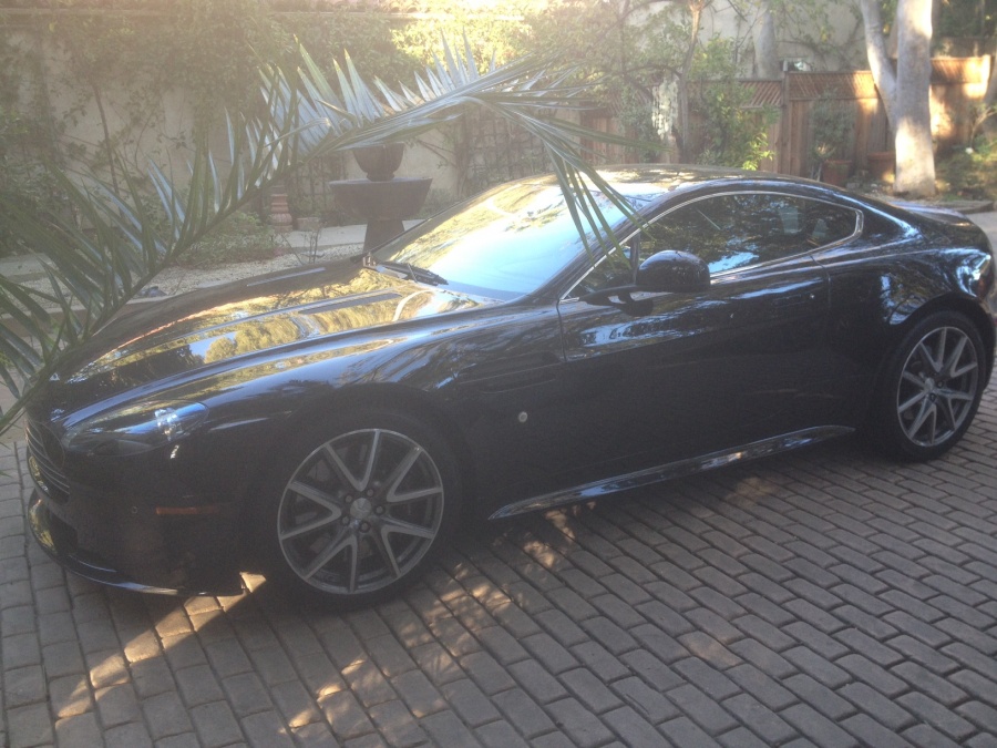

not sure
Does not show the up close damage but either way..

Good advice. Couple of things I may add and better clarify.
1. Paint correction is defined as legitimate removal of imperfections such as swirls, scratches, water spots, etc. There are different levels of paint correction. It can be something as simple as a light polish/pad combo to get rid of washing hairline scratches that cannot be avoided. These fine scratches can be hidden with paint cleansers, but removed using light pad/polish combo without jeopardizing the paint integrity. On the other side of the spectrum, a paint may need several stages of polishing and/or compounding to remove more aggressive defects from poor care or improper detail work performed. So, to clarify, paint correction can be done even on a new car if it needs it.
2. Aston has one of the best paint jobs in the world, however, it requires a skill hand to bring it out. Aston paints are sanded using a pneumatic dual action polisher/sander. Many times, dirt and grit get in the sanding pad and leave what we as detailers call "pig tails" and/or marring in isolated areas. Aston merely glazes the paint and by the time the cars arrive here in the US, the glaze has flashed off and you're left with the imperfections exposed. Almost every Aston we've encountered has this issue. To remedy, we can either compound or sand the imperfection and through several stages of polishing, bring out the brilliant paintwork
Hope this helps a bit.
Here's a Vantage we did a while ago. Make sure you get specialists in the cars you have in order to make sure the correct work is done while maintaining the integrity of your Aston Martin.
