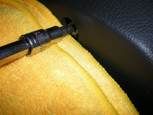

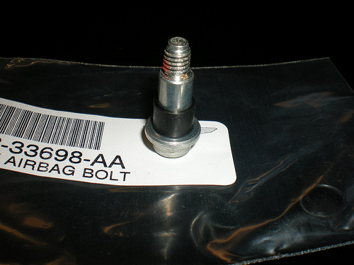

Installed the sleeves last night. Quite an easy job. 10mins max.
Requires T-30, with a 2" extension and a ratchet. Posting a couple of pics, not a detailed diy.
Please note the part number is for ONE black sleeve. Bolt is from your airbag. There are two airbag bolts so order TWO sleeves.

thats fantastic my sleeves arrived in Cape town today will fit on weekend ...does it take the steering wheel noise away when you go over bumps?
Haven't had a chance to drive since. Pretty sure it does. Less play when you wriggle the airbag.
