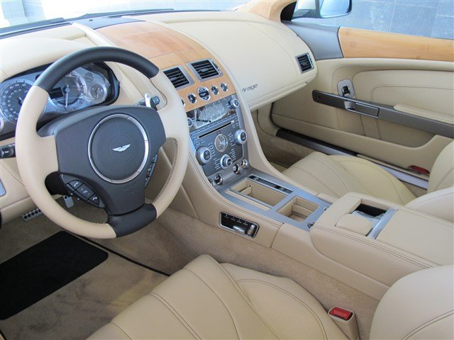

How difficult is it to get the seat controls panel out of the console side?
I have ordered a V8V and the Q program could not put in the new seat controls from the DB9/Virage that have aluminum accents because they said it had a different connector than the V8V. I think they look so much more classy than the black plastic ones in the Vantage. I am considering ordering 2 from the dealer and installing them myself after splicing on the old connector in place of the new connector. How do you get the old ones out? By taking off the top of the console with the ashtray etc in it? How difficult is that? Thanks for any input.

Some of the UK guys have looked at this when they first appeared on the Virage
Apparently its not the plate with the switch but the cable connectors further down the loom.
They don't match so you would need to get hold of the right connector and splice it into the loom to make it work.
Getting to them is a fair bit of work starting from the console

Forget the idea..would be nice but would cost to much. The V8V's still have the old switch style with the new module adapted to the old systems. The Virage/New DB9/Rapide, all have the new switc hpack with the new module.
Old switch uses multiple wires for each seat movement/motor..new switch uses 3 wires only(pwr/gnd/LIN) ..you would need the whole system setup to run on a LIN network..$$$$$ ..would be cheaper to chrome or billet cap your original switch
