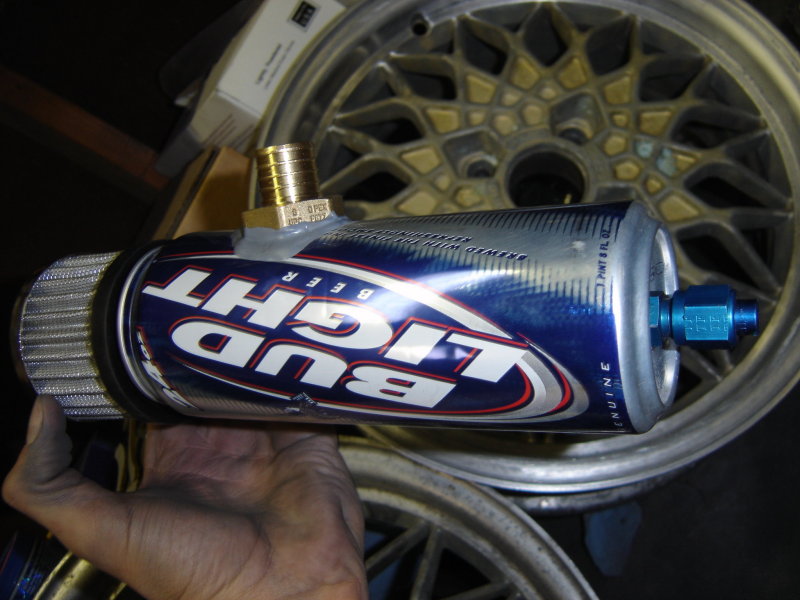

For anyone worried about spending this much on your Aston Martin, you could always go this route and save a few bucks
You offer so many tempting options...
