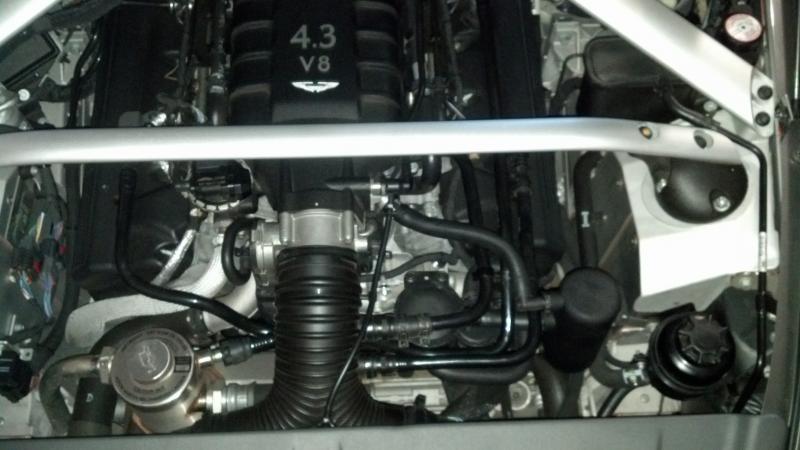

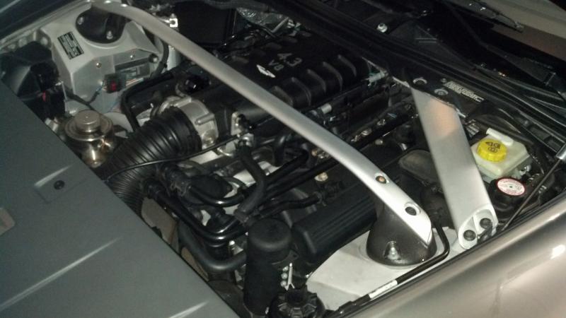

Picked up the brackets today. Sorry for the cell phone pics, but here's how the kit looks installed:
We changed things up at the last minute, so I'm waiting on some more hardware. It should be here in a few days. In the meantime, I'm looking to see if I can get my hands on some 45-degree fittings to replace the 90-degree fittings. The 45's should give a slightly more direct path for the hose going into the intake manifold, and should clean up the look a bit. I'm not seeing any from a quick search, so I might send the kits out as-is and then I'll send the new stuff if/when I can find it.

Guess I'll update this since it's been a while. I've put a bunch of miles on the car since first starting this project and it's done a great job of collecting oil. It's a bit disturbing how much it collects - lots of oil getting through the PCV and into the intake manifold. I haven't had any issues at all with it and it still looks like it belongs in the engine bay - even more so with the new 45-degree fitting (read below).
A while back I ordered a pair of aluminum fittings to replace the plastic ones. A lot more expensive, but worth checking into. The two I got are black anodized from Earl's.
The straight one to replace the fitting for the lower hose DOES NOT fit. The fitting is too long and the distance between the catch can and the PCV is too short.
This is the straight fitting that DOES NOT fit:
Earl's AT984010ERL Hose, Straight, 5/8", Aluminum
The 45-degree angled fitting replaces the 90-degree fitting at the top of the catch can and looks MUCH better. Only downside is that the fitting doesn't thread in completely, so there are some exposed threads. However, all-in-all, I prefer it to the plastic one it replaced. Look for this and you'll find it:
Earls Plumbing AT984410ERL Ano-Tuff Adapter
A quick note: Hopefully the 45-degree fitting is in stock. I ordered it in February and it just came a few days ago. At one point I was told it wouldn't arrive until July! Also, it shortens the distance the hose needs to travel so I had to trim about 1" from the hose.
