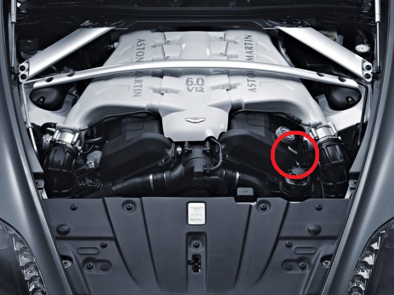

Just now digging into this thread and contemplating adding this to my V12V. Do you know if your system will work for the V12?
My kit won't fit on a V12 because the engine, intake duct, and throttle body are all in the way:
Fittings would be different..But you could use the catch can minus the brackets and mount them yourself in place..btw you would need 2 catch cans for a V12, there are 2 PCV's that feed to each air intake tube
as soon as i saw Racer_X's post, i pulled up the diagram to see where the system was since it couldn't have the same layout as a V8. looks like the PCVs are under the intake manifold, is that right? if so, it'd be a lot more work than my setup for the V8!
There are 2 oil air separators in the engine valley area(below intake and fuel rails), both are on there own circuits, they goto there own pcv at back of the head, then a vent from the cam cover goes to this hose, hose then feeds to the intake tube few inches in front of the throttle body..left and right side systems are a mirror image
