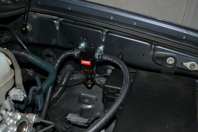

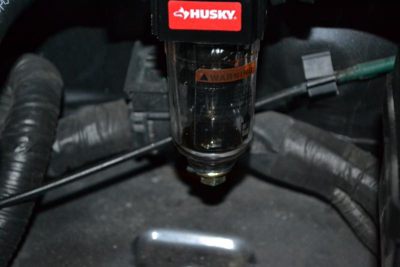

Also, I wanted to tinker with my 4Runner over the weekend, so I put together a ghetto catch can. Cost about $25 in all. Not pretty, not perfect, but it gives an example of what a catch can is able to do.
Looks to be about a tablespoon or more of oil. This is after only 55.1 miles of driving. That's about a quart and a half between 5k-mile oil changes!

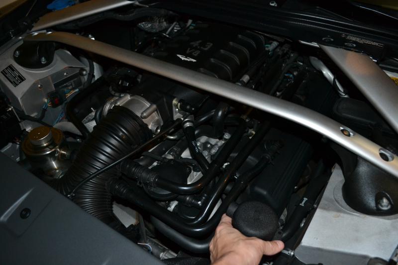

FINALLY!!!
Wrinkle black finish in position:
Polished finish in position:
Polished finish next to oil canister for finish comparison:
Sorry the pics aren't that great, it's been a long day and I'm holding the can with one hand while taking the pic with the other. Both finishes look great, though!

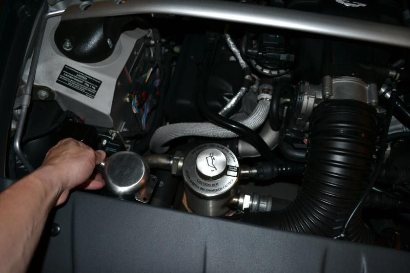

Rep Power: 295
Installed in-line, sans bracket. I'm still going to find some better fittings, or modify the ones I have to be up to my standards. I'm very impressed with the quality and workmanship of the can, and it looks likes an OEM piece. It'll fit somewhat better than you see in the pic below once I get it properly mounted and with improvements to the fittings.

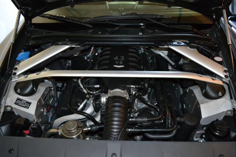

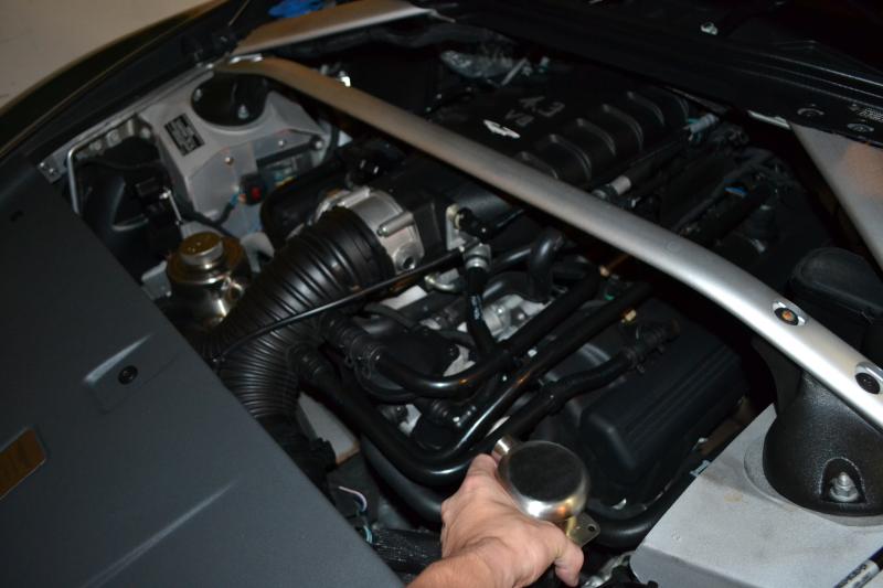

UPDATE (sorta)
My fabricator fell off the face of the planet so I'm looking around for another one. I've been testing the effectiveness of the catch can on my car, and it feels like it's running a bit more smoothly. I posted some pics in another thread, but here they are again. Sorry for the crappy quality, they're off my cell phone.
Here's where the catch can is sitting, without the mounting bracket:
The hose on top can be routed above or below the three plastic hoses, depending on whatever you're comfortable with. I've got it on top for stability while I'm waiting for the bracket.
The connectors I'm using are the actual connectors from original factory hoses. I'm buying new hoses from AM and cannibalizing them for the connectors since I couldn't find a supplier for the connectors alone.
