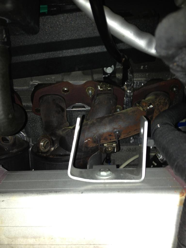

SubscribeStarting to make some progress...
Turns out we made a few errors on the initial fabrication. Had to make a few modifications to make them fit, but I think they came out pretty nicely.....
