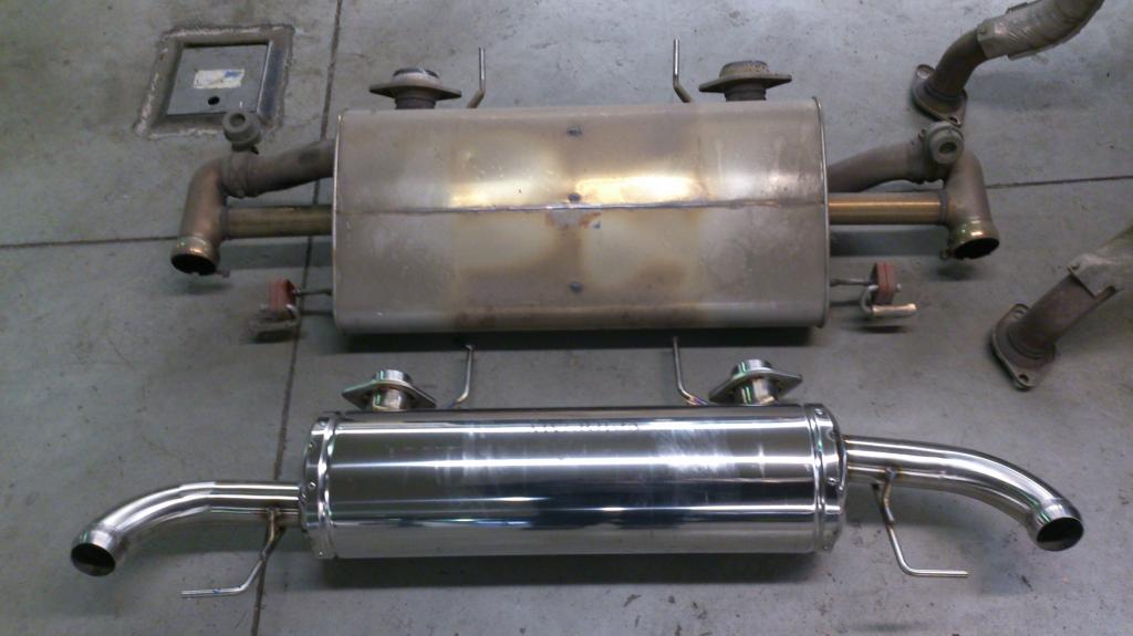

The Velocity AP exhaust ready to Install:

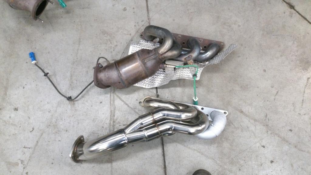

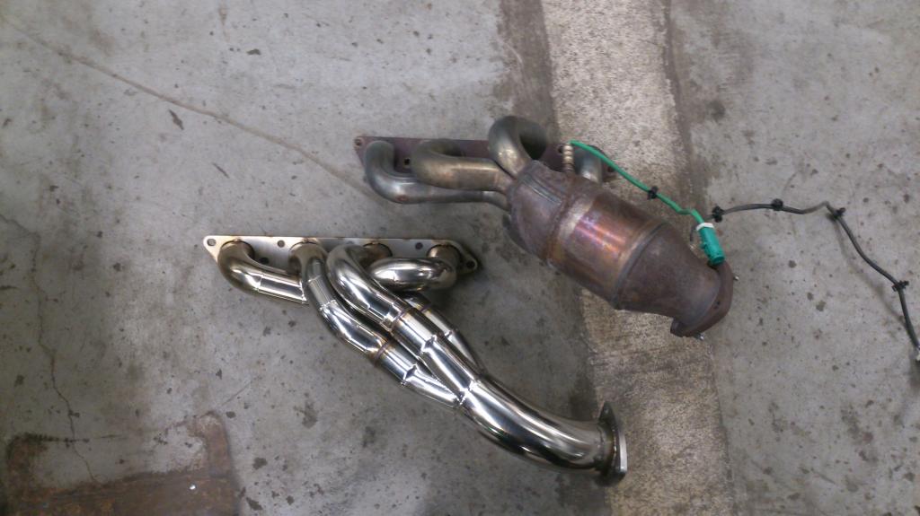

Comparison to the OEM Boat Anchor:

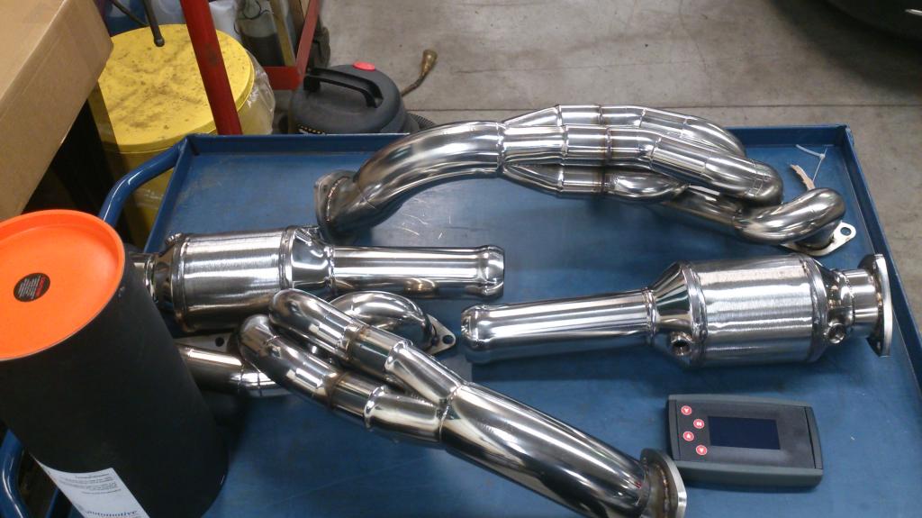

LHS Manifolds:

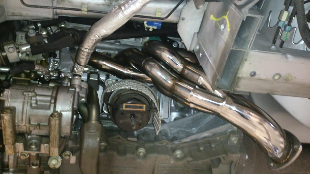

In they go:

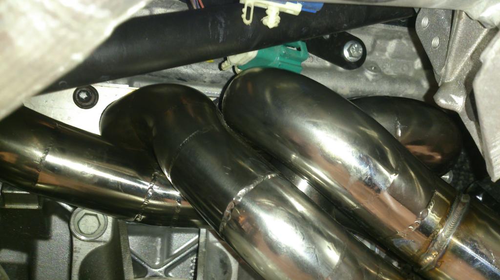

Snakes on an Aston:

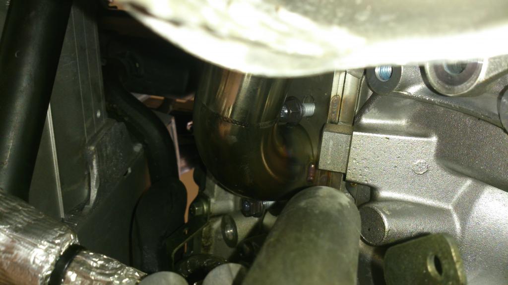

One of the downsides - some of the header bolts are tough to access:
RHS Going In. Client installed some heat wrap on the first Primary next to the Alternator for added peace of mind:

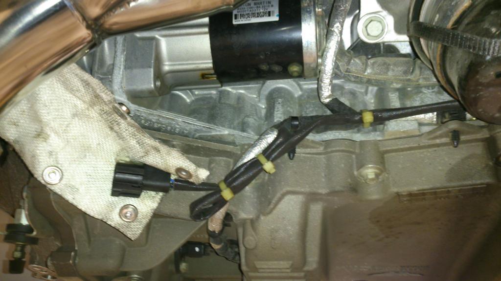

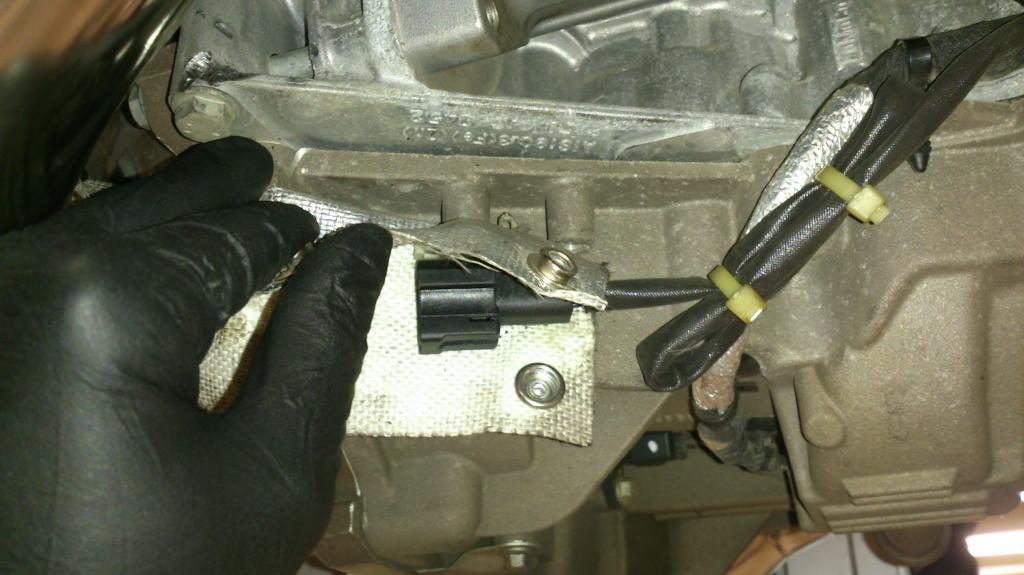

O2 Sensor Harness Extensions in place, Professional job in securing them nicely out of the way:

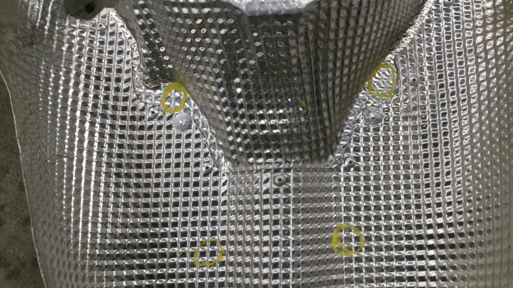

Heat Shield in Tunnel Marked for Drilling:

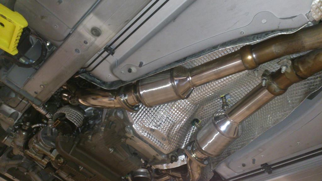

With Velocity Headers and Catalysts installed - back in their original 2006-2009 location in the transmission tunnel.

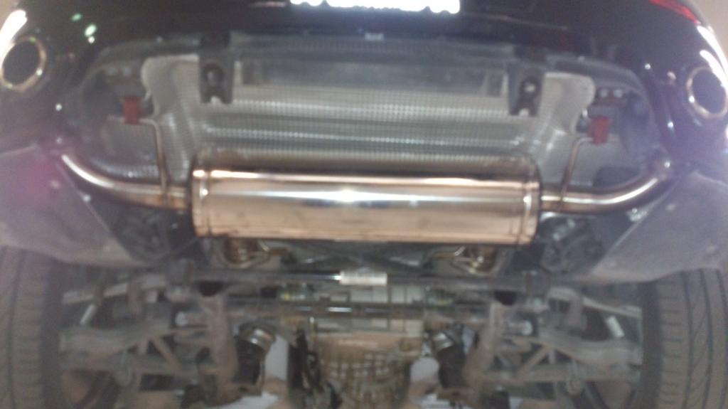

VelocityAP exhaust is installed. Room to stow a Cygnet or two in under there now!
