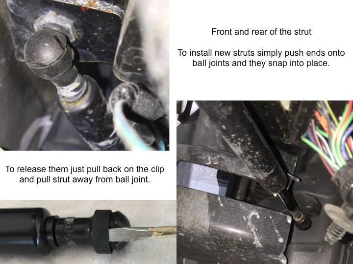

I replaced the strut on my V8V today and it looks different than the DB9 pictures posted, but the rest of the post applies the same. The picture below was taken looking at the back of the wheel well toward the front of the door. I am slow- took me 2.5 hrs...

That's it! And the struts are universal-same one works for L or R.

If you do this on a lift to make under tray and wheel well liner removal easy, you MUST be able to open the doors ALL the way, otherwise you'll not be able to install the new strut since you will not be able to compress it to attach both ends to the ball mounts.
I learned this the hard way. Had to take my car off the lift, back it up, and lift it again so I could open the door enough.

Just thought I'd add to the thread. Got around to doing mine this afternoon. Wow, what a difference. Relatively inexpensive ($57 from my nearest dealer) and done in about an hour.

Ordered the struts from astonmartinbits.com and installed them this morning for my 2009 DB9 Volante.
The first one took more time. I was very careful since this is the first time I've worked on this car. The second one went much faster and now I don't have to play defense with the door when exiting the car.

Yep, Did mine last month. I used a piece of foam in the door jam to position the door where I could get the most direct access to the struts and clips. A "door" person would have been great. The many DYI posting on this forum was the big plus to tackle this needed change out. My suggestion- Don't get into a rush. It took me a little over an hour on the first one and about 1/2hr on the second. Make yourself plenty of room (yes, remove the side marker light) and light up the internal space up (I used a small LED light). I should have done this sooner!
