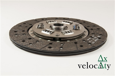

V8 Vantage Clutch Friction Plate Only
By popular demand. You can now order just the friction plate. The OEM replacement is only available as a pressure plate + friction plate combo.
This is a slightly uprated version, still with organic facings so will operate almost identically to the OEM setup.
http://www.velocityap.com/Aston-V8-V...lutchplate.htm

Great option to have just the clutch disc. Most of the time the pressure plate is just fine and does not require replacement so this greatly brings down the cost of the clutch replacement.
great idea!

I drive a friends car a while back with the RSC clutch kit (back when you used to work with them). It felt totally different to the stock unit. Was that because of the clutch disc, or because of the pressure plate? Which one has more of an effect on engagement between the two?

Can't comment specifically on that unit, but in general it is probably a combination of both. The pedal pressure is affected by the pressure plate - the speed of engagement/disengagement and the amount of force required. The friction plate is going to affect the amount of slippage, but since both are working in partnership it is probably hard to separate out. They both make a different.

What are the key differences between your pressure plate and the stock pressure plate? Does yours have a different spring rate for the hub springs or are they identical to stock?
What about the friction material, is it different in any way?

Have done 275 miles now with the new disc and no problems. Engagement is smooth and the engine is eagar to rev, unfortunately I am still breaking it in, so no really hard acceleration yet. Hopefully I will report back next week and I can find time to put her on the dyno with the chips....... The clutch is engaging very nicely and no noise, however, my stock slave cylinder and throwout bearing were fairly worn. Glad we replaced it with new! The throwout bearing was very noisy and wobbly, whereas the new one was nice and tight and there is no rattling on engagement.
