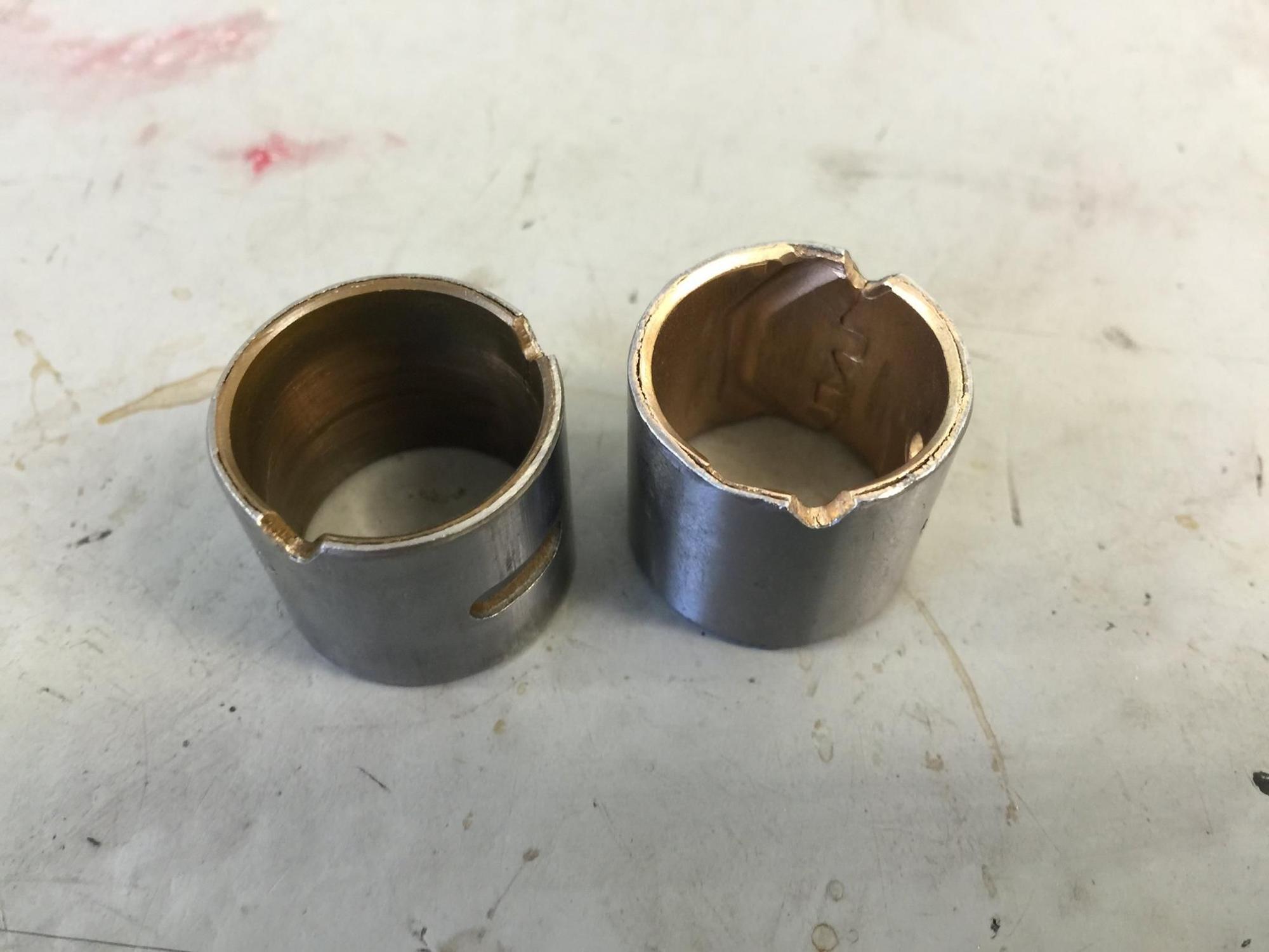

Hello my colonial friends,
I'm in England and I have a DB9, mine had the, "tick", I tried everything, pretty much the entire thread on this subject is me and what I did, Including Bamford Roses, "denial", bit, that is true as well.
After living with the tick for about 12/18 months or so, I am an expert on the V12 tick.
Why do certain people get it an others don't? Variable reason I guess, but a biggie for mine was, overheating. Don't all rush to your typewriters to tell me your dial is fine, mine was too. My radiator was blocked up, so instead of a nice cooling radiator, I had a nice warm blanket. Engine got hotter and hotter and every single thing that Bamford Rose said.... happened. I even have photos of the problem.
I was experiencing oil pull, oval cyds, ticking. Everything.
Eventually the only way to overcome the problem was to have the engine stripped down and renew all the bearings, rings etc etc etc etc ..... wicked engine now.
If you look at the small end bearing, the old 450bhp engines are just a ring. In the new replacement Bearings, there is a grove in them. This stops oil starvation to the small end bearings. I have a photo of this as well.
My eyes are tired and i'm off to Noddy Land, but please re-read what Bamford Rose has said, everything he said is spot on..... including the denial bit :-(
Clear out your radiators, or replace them, in England they are about £350.00, I replaced mine (I have photos of that to) I also changed my Thermostat with a Vanquish (new shape) one that opens at 10C lower than the standard DB9.
My tick is gone and the engine runs as sweet as a nut. I will forever be careful to ensure that the engine runs as cool as can be. .... please PM me with any questions.
You will need to PM me as I only just joined this forum and I won't be able to check it regularly.
PS, I used to use a forum in England, but the sarcasm was so bad I came off it.

Listened to your video and mine was exactly the same ..... I have videos too of that sound .....
The small end bearing on the left is an old one and the new type on the right, you can see the grove for the oil cut into it .....

Nice to hear from you again Maverick -- it's been a long time. I think you'll find a warmer reception here than you received on PH
Glad to know you got your car running again, though I shudder to think what you've spent to do it.
