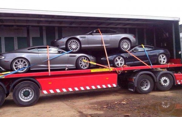

Just don't do it like this...

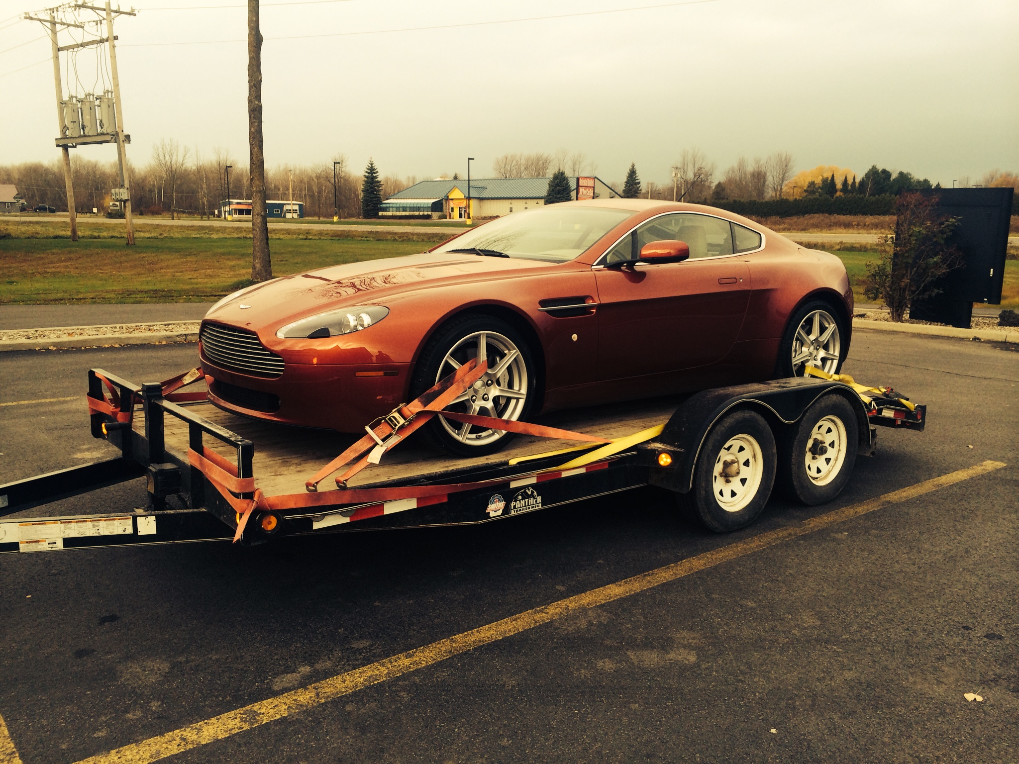

All - I guess there are no other ways to tie them down other than the wheels??? I don't want to damage HREs or change back to the stock wheels for transportation...

When I bought my Vantage it was shipped to Ogdensberg NY and I trailered it back to Canada myself . I tied it down using fabric ratchet straps heavy duty 5000lbs threaded through the wheels and pulling away from all four corners .So effectively the spokes in the wheels were taking the strain . Worked good for me and the straps didn't mark the wheels .
When I got the Beemer from the US the shipping co had straps that went over the top of each tire front to back and tied it down that way . It worked well but when I first drove it after getting it off the trailer it felt like the wheels were square as the tires were a bit deformed from the strain . Once the warmed up a bit all was ok again .

You can strap through the wheels as in the picture but you should have the strap at the bottom of the wheel. if it is at the top and you hit a good bump the wheel can slip and thus loosen the strap. The straps should also be in an X attach the right front of the trailer to the left rear tire and so on. Eddy

Fyi If I saw such a car as the one above strapped as it is I would quickly take off my white gloves and slap the person who did it with them......LOL

The straps will go through the wheels - but should secure to the barrel of the wheel, not the spokes.
