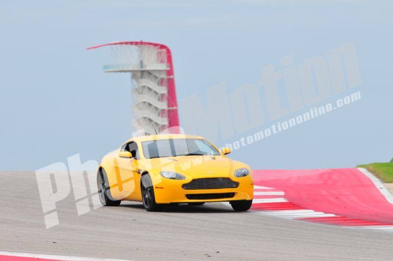

I had my V8V out at Circuit of the Americas this weekend. I was instructing and wanted to see how the car would do. As was said, it's amazingly well sorted for what it is. Easy to drive, very predictable, and very neutral in the corners.
Now I need more horsepower, stiffer springs, and better brakes.

You've got some lean going on! I've got H&R springs and they're amazing on track. Very aggressive drop, though. VelocityAP is developing a set of springs with less drop if ride height is an issue. Definitely worth getting springs, either way!

That photo is of turn 10. It's a fast downhill sweeper, I've been building speed since turn 8, and cresting the hill is somewhere around 100 mph. You have to turn into a blind apex and stay on the throttle the entire time. Lifting here ends badly and it's a real gut check to not brake before corner entry. I love that the photographer caught me right at the apex.
I go through Stuart at VelocityAP for most of my stuff, I'm pretty sure he sells the H&R springs as well as the ones he's developing. I believe RSC sells them as well, and I'd imagine any H&R dealer can source them.

It's the toughest track I've driven though, many corners are blind or designed to trick you into false apexes or bad lines. You also really have to think about complexes as few corners aren't linked to others. And I honestly believe to understand the line in T3, you need to think about the line in T10.
