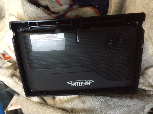

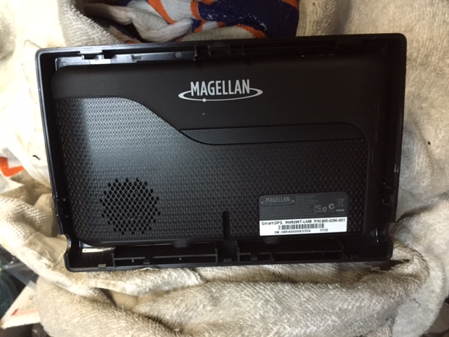

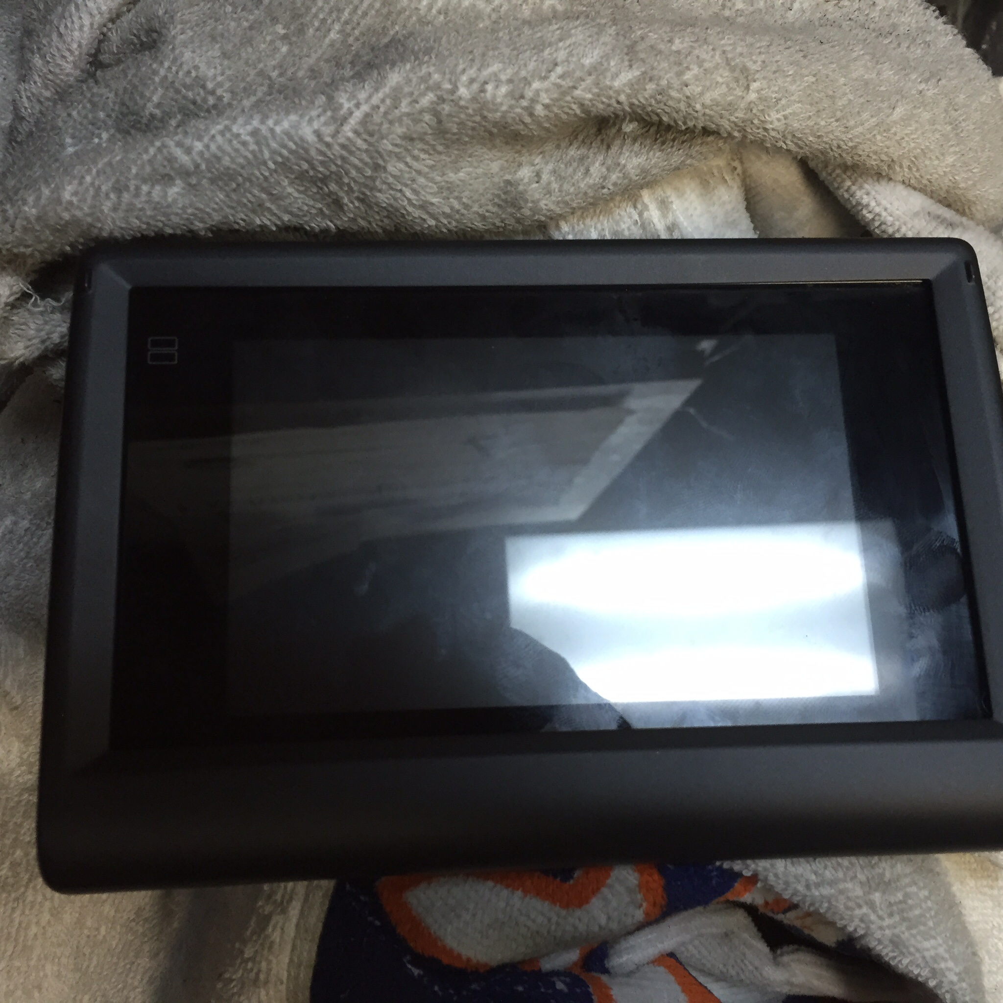

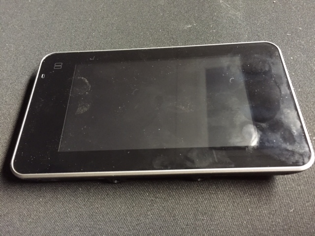

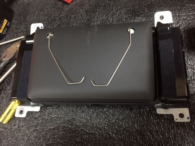

I started with a magellan smart GPS 5295. It fits perfectly in place of the original screen and is a state of the art touch screen unit.
I had to gut the entire original screen housing, shave down the sides of the new GPS unit and fit it in the original screen housing.
I drilled a hole in the back of the housing for the sound to come through and hard wired the gps so it comes on whenever the ignition is turned on.
Bad part was I couldnt figure out how to make the screen go up and dome with the ignition so I had to wire it to a remote so with the press of a button it raises and lowers.
Here are some pictures.
