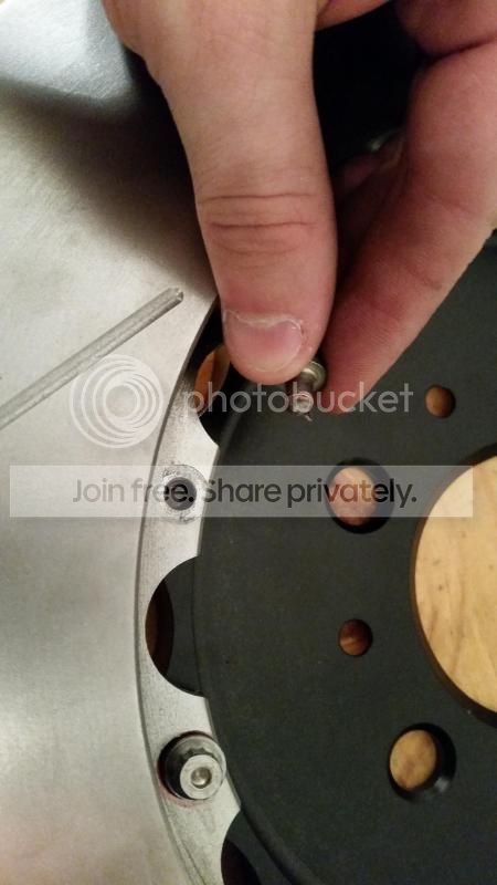

Rule 2 and the particular subsection stated above come into play when I was assembling my 2-piece brake rotors. This is actually an easy job. However... Long story short, I was in a big rush, wasn't paying attention, and used the wrong torque wrench to irreparably damage one of the aluminum rotor hats. That was an expensive little lesson, but a few phone calls, a few hundred dollars, and an overnight shipment later, my new hat is here and everything is properly installed.

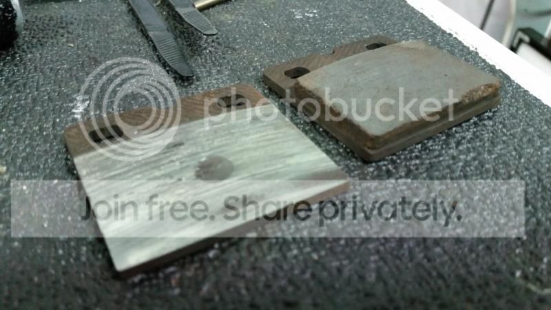

Next up: VERY thorough inspections of our cars is a good idea. A good month or so ago I took my car to the dealership to figure out what a clicking noise was coming from my right rear wheel. They said everything was fine and it was "normal". Since my car was partially torn apart for the brakes, a bit more disassembly showed that the clicking wasn't quite normal.
Here's a fun one. The missing pad wasn't worn through. It actually fell off about a week ago. No idea how or why.

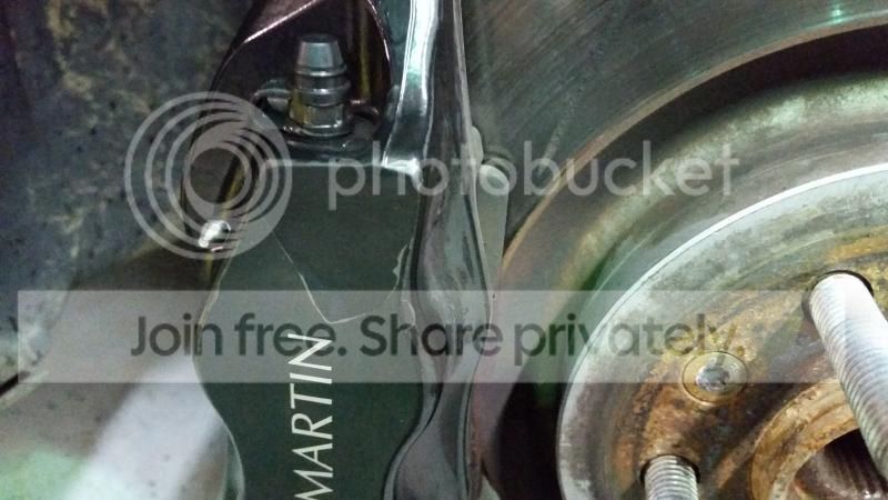

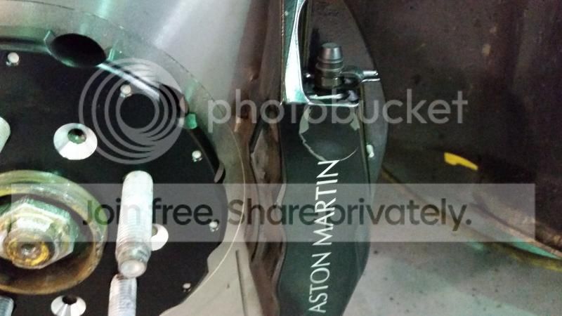

And last thing off the top of my head (I'm sure there's more lol), the clear coat is coming off my passenger-side brake calipers. Driver's side *seems* to be holding up.
