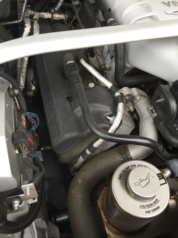

So checking my oil during a fill up today I noticed my V8V engine compartment has become quite dirty, mostly with dust & pollen. Just wondering what you guys are doing product & procedure wise to clean out your engine bays?

Im also interested to know, have not pressure washed my engine bay yet....I had the disappointment on Friday to drive my car in the rain for the first time since it left the factory, the Wx came in unexpectedly while I was out.
Look fwd to hearing from the detail kings
