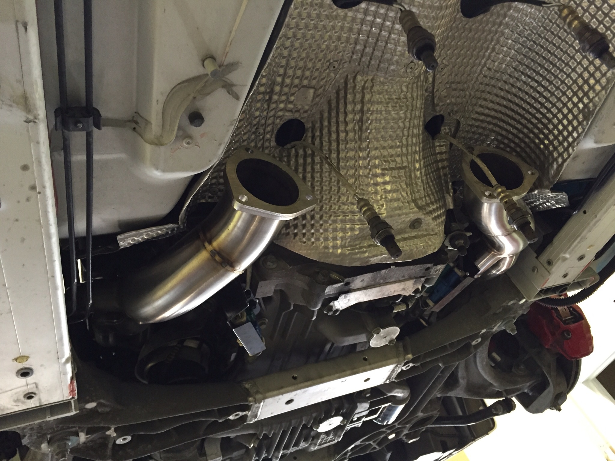

Anyway, I can report it is POSSIBLE to replace the headers without dropping the subframe. This is certainly not a contradiction to what Irish said. I had the help of a very competent mechanic. However it took about 3 hours of maneuvering (and salty language) to accomplish the difficult side. Might be easier to do it the other way. Certainly not a DIY for the average person.
