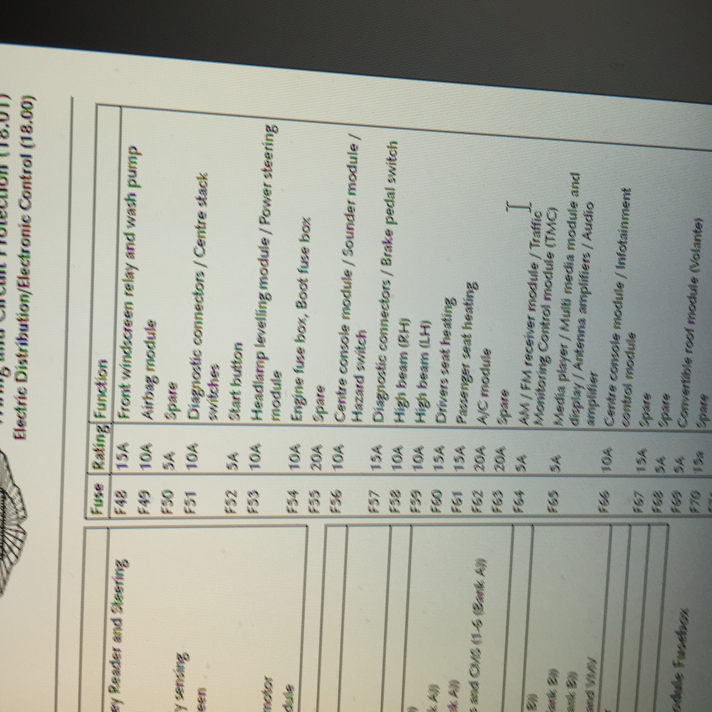

Internet downloaded owners and service manual both says fuse 55 is spare 20 AMP
But it was actually for cigaret lighter so what am I misding?
I will post picture from manual next

Manual says issue 2

I've got issue 2 WSM & F55 shows as spare. I've also got issue 7 (dated Sep 2010) and F55 is spare there too.
But my 2006.5 Revised Wiring Diagrams manual show F55 as Socket Accessory Cigar lighter.
Seems a bit random?

Humm...I learn something new everyday. I have circuited diagrams and it does show fuse 55 for cigarette lighter.
I almost paid for astonmartintechno.com for version 7 thinking I had wrong version.
