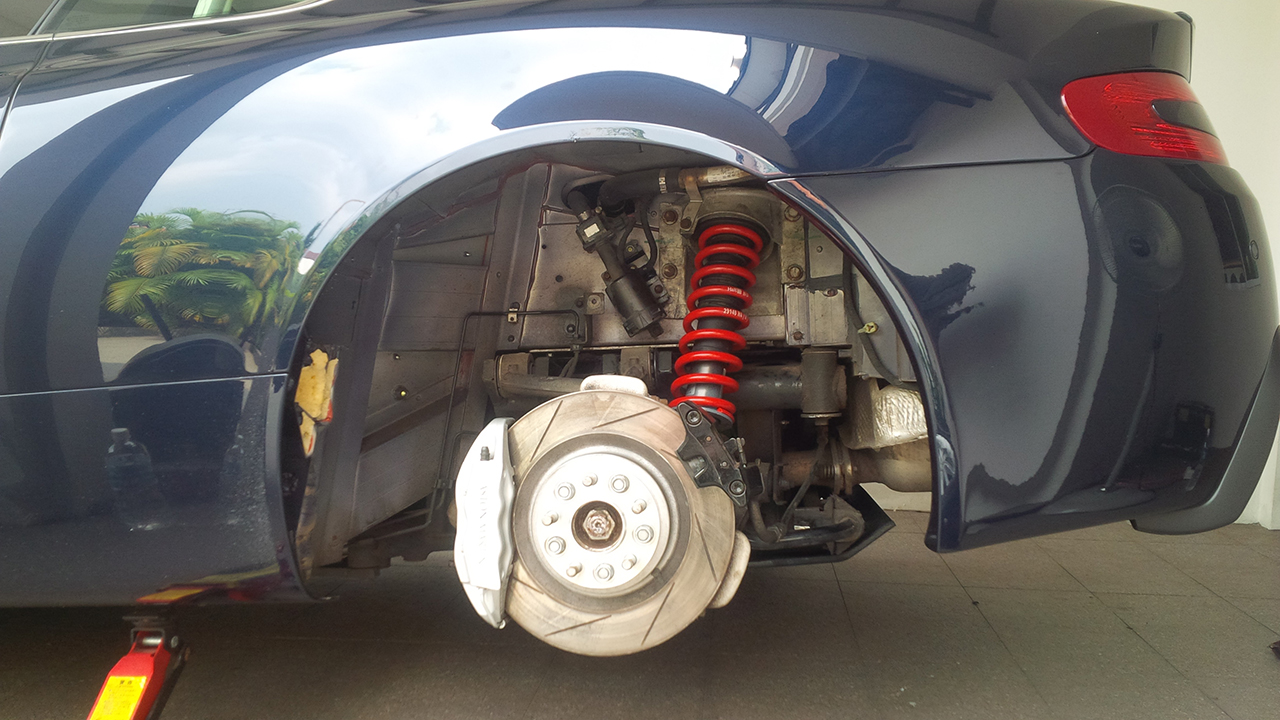

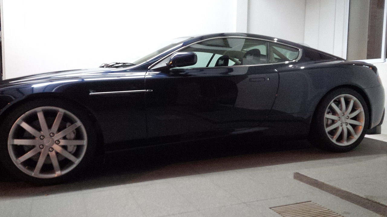

Hi fellow members,
SRINGS
I tackled a DIY lowering job by means of swapping the OEM springs with the H&R-29148 over the past 2 weekends on my DB9. I first lowered the front axle and did the rear-axle the weekend after (without driving in the interim).
From the day the DB9 was shown to the public I've loved the standard 19" rims that came with the car. I've never been a fan of 20" rims on DB9's. Although I love the DBS-wheels they just do not seem the right fit on a DB9.
The one thing I've never liked though is the gap between de fender and tyre. Most will agree that in an ideal world the tyre radius and fender radius are parallel (as per stock setup). I do love the stance with the H&R springs installed.
As for the drive: it still feels brilliant although I've not driven enough yet to put up a final verdict: these springs need to settle first and I also need to have wheel alignment checked on the car.
SPACERS
I only have 18mm/0.71" spacers installed on the rear-axle. The front has no spacers yet but will most probably end-up with 13mm/0.51" spacers.

Originally Posted by telum01
Awesome stuff! I'm surprised the spacers were thick enough to cover the factory studs.
I had spacers installed that have the 5 new studs on them were the wheel will have to bolt on to. I had to cut-off the factory stud-thread about half an inch and also had to run-off on my lathe the hex-head on the M22x1.5 provided nuts used to mount the spacer to the hub: this to enable clearance of the nut inside the rim-recess.
I think I shall upload a picture which explains it all..
Since I reckon 13mm spacers will do on the front-axle I intend to install longer hub bolts only.

I owe you indeed pics of the mounting of the Bride-seats. Forgot all about it. Will make these come weekend!
Below picture shows the nut-protrusion on the spacer: the green line on the nut shows the edge of where I ran-off the hex-head but still keeping the full thread height.

The final post to close this thread: a BEFORE & AFTER of the car which shows the great looks this set offers. Riding & Handling is still superb apart from the speedbumps which need a lot more care taking..
