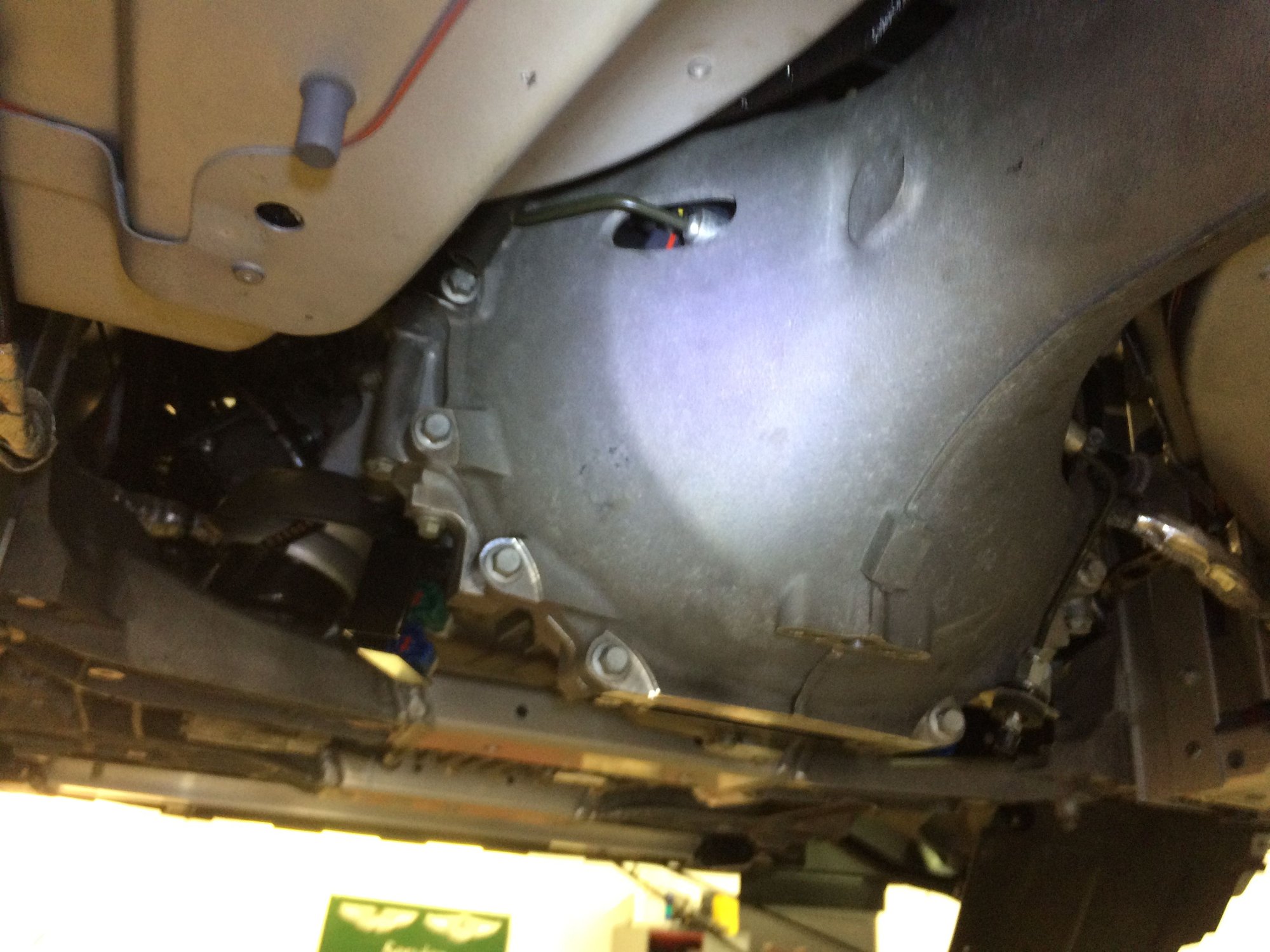

[I]2 My six speed Graziano transaxle on the shop floor. Out put shafts, L &
R, have been pulled. Requires a transmission jack and additional help to
remove and replace.

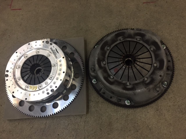

[I]6 OE flywheel friction surface encircles the 8 bolts which attach the
flywheel to the rear of the crankshaft. On the perimeter is the ring gear
which was heated, then slipped over the cast iron flywheel and allowed to
cool creating the assembly. Poor picture, but dark spots, burns, are caused
in a V8V by backing up or spirited driving.

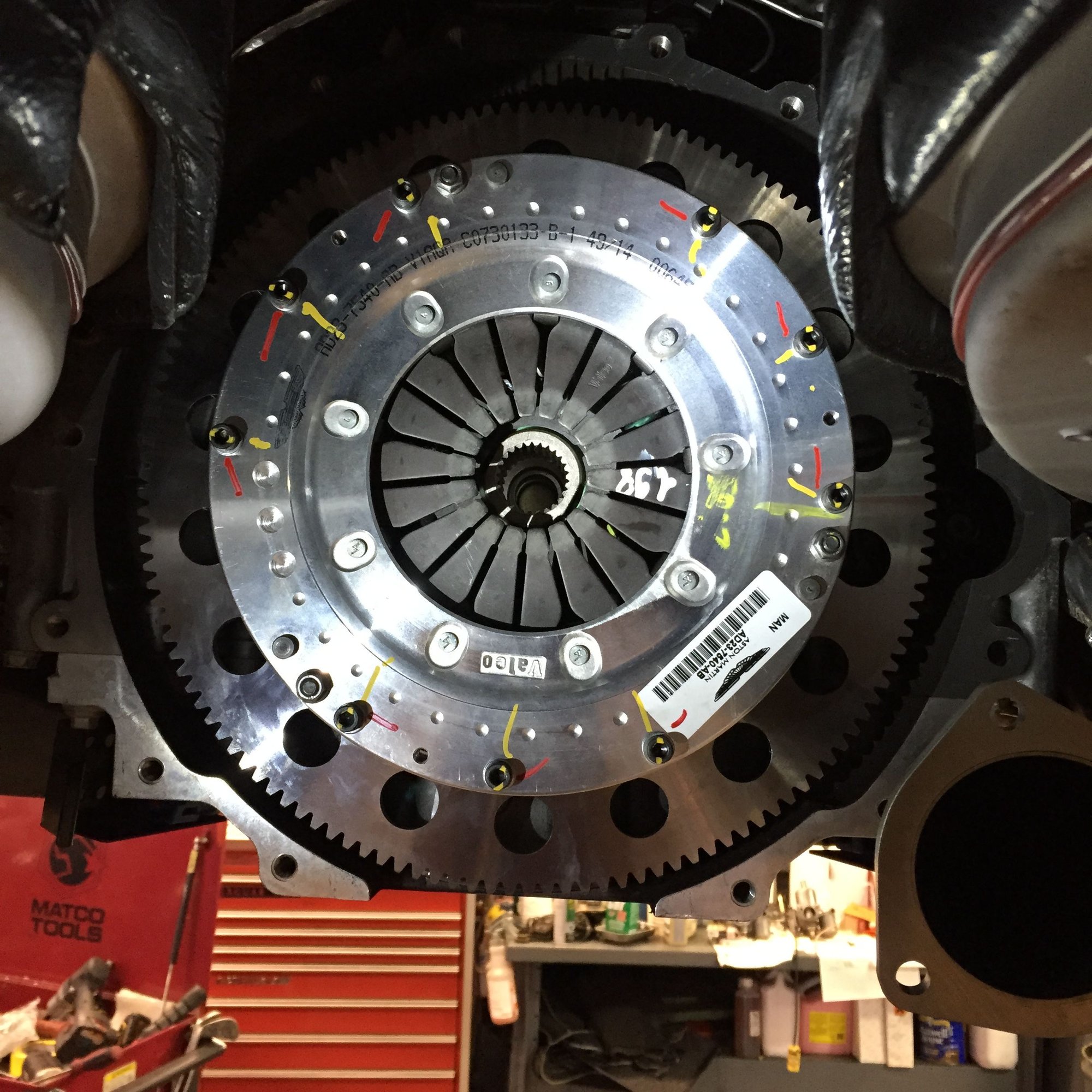

[I]7 The new VelocityAP twin plate clutch and lightwt flywheel finally in
place. Note the unique billet steel flywheel with integrally machined ring
gear teeth as well as a fair amount of swiss cheesing. Brighter still is the
aluminum case of the twin plate clutch. Looks like jewelry to me. Now the
reassembly can proceed.

I recently arranged to have Tim Unsell at the new Walnut Creek Aston Martin dealership install one of Stuart’s lightweight flywheel/clutch kit in my 2007 6 speed manual Vantage, with approximately 38k miles on the OEM clutch (I’m the second owner (July 09) from 6700 miles onward). I was having no problems with my clutch, but I thought why wait for a problem to present itself.
FYI, I do track my car (3 to 4 events a year at about 7/10’s).
Ordered the kit from Stuart and, despite a minor delivery hiccup, the kit arrived in time for my scheduled installation date with Tim.
Left the car and the materials with Tim at 2PM on a Monday and the car was ready to go later the following afternoon!!!
I can’t say enough positive things about Tim and his professional response to my questions and concerns. I have a lift in my garage and I could have done the job myself, but it would have taken much longer and I would still have to have the dealer perform the relearn of the misfire codes. All things considered, having Tim perform the installation was money very well spent.

The replacement twin disc organic clutch is indeed an Aston Martin part, identified as a “V12 twin clutch”.
I doubt the V8 Vantage will ever reach the HP limits this clutch is capable of handling-equate that fact to longer life.
The flywheel is as pictured in Stuarts posting and both components look even more impressive in person.

Tim took two photos of the clutch components which are included here:
Clutch Kit Specifics:
Due to the minor delivery issue, I didn’t have time to weigh the kit components before installation. My OEM clutch and flywheel graces my bathroom scale at approximately 40 pounds. The shipping weight of the kit was listed at 20 pounds. Weight savings will be somewhere between the 17 pounds mentioned by Rick (flinder) in his posts and my estimated 20+ pounds…truly a substantial savings.
(How much would 20 pounds of weight savings cost using carbon fiber bits
? – a question mentioned by another 6speeder in a different post).My OEM disc measures about 8mm of thickness remaining. Does anyone have a thickness dimension for a new OEM disc?
There is less than 1 mm remaining on each side of mine before the diagonal slots will be completely worn away and the disc surface would then be completely smooth on both sides.
There is additional material (1+ mm) before the surface of the rivets would then contact the flywheel.
