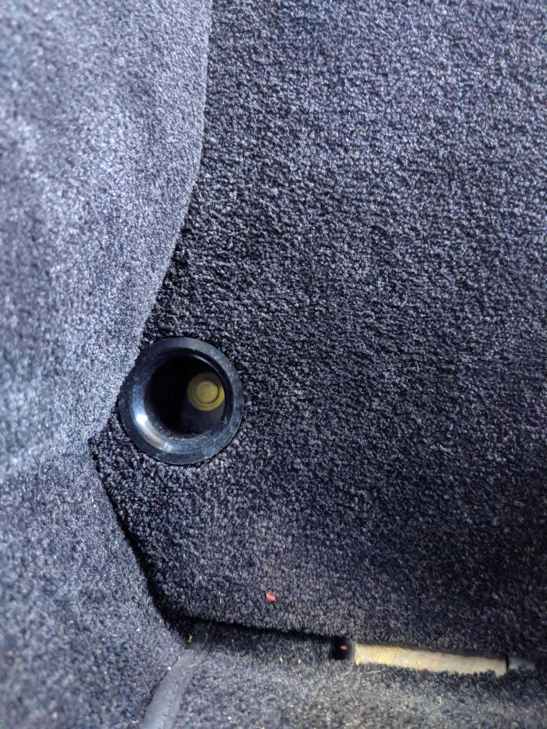

V8 Vantage Battery Re-Connect switch location & picture
Hi, read the postings and thought a picture of the battery reconnect switch might help. Mine is a 2006, US model. Yellow button down low on the panel behind the passenger seat. My manual wrongly stated that there is no button i.e. that inserting the key in the ignition suffices (page of manual also copied). Hope this is useful.
