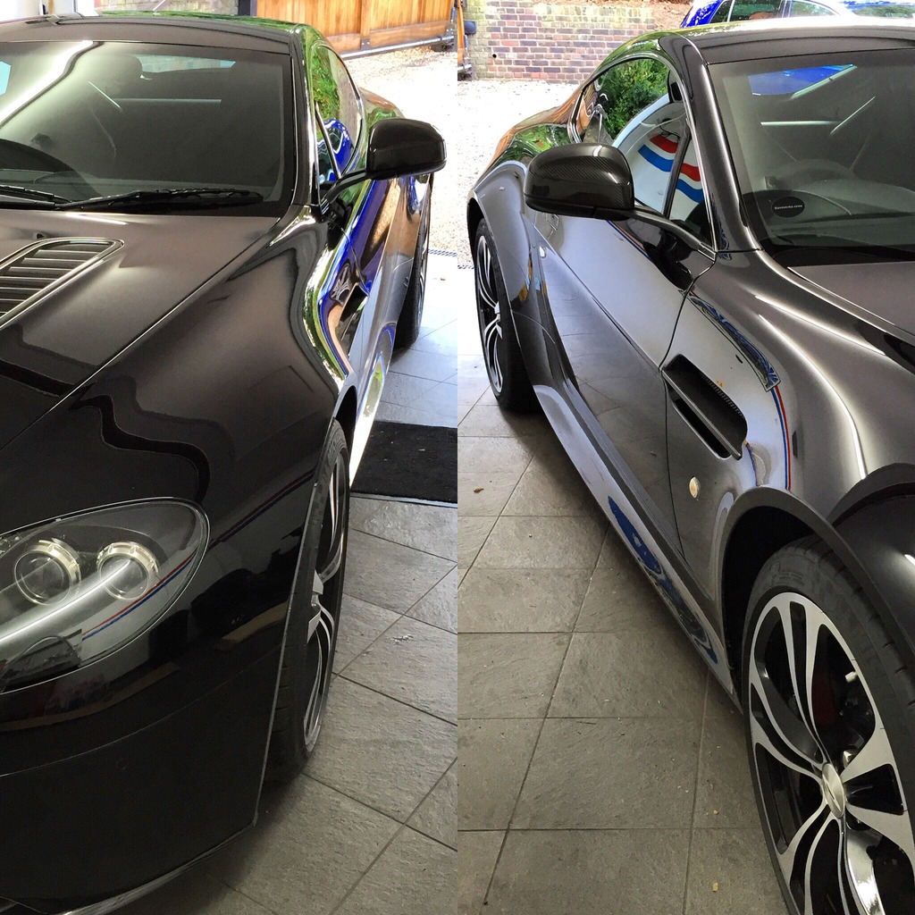

I fitted 5mm spacers to my car it it looked so much better but be warned the OEM lug nuts are not threaded all of the way through the nut so I would advise changing these so you are not losing the amount of threads that are holding the wheel to the stud.
Find some decent lug nuts that are threaded all of the way through and you can go 5mm and I would say 7mm are easily possible too.
A comparison pic.

With the smaller spacers you also need to consider how much of the hub lip is exposed to secure your wheel in place. 5mm spacer still leaves around 6mm of hub lip exposed so still a hubcentric setup.

If that change pictures is only 5mm, that looks like a substantial difference. I could always get meatier wider tires to make up the difference (once the corsas wear out I can switch over to PSS to give me another 5-7mm on top of the spacer.

007, the pictures above are a bit deceiving because of the different angles at which they were shot. This creates the illusion that the one on the right is much further inset versus the left because you see a lot more of the wheel well. Go grab a ruler and look at how small 5mm really is. We're talking about somewhere between 1/8 and 1/4 of an inch. Do you really think that this difference will be noticeable by anyone besides yourself when you are done? Is the effort, expense and safety risk really worth it for such a miniscule difference.
