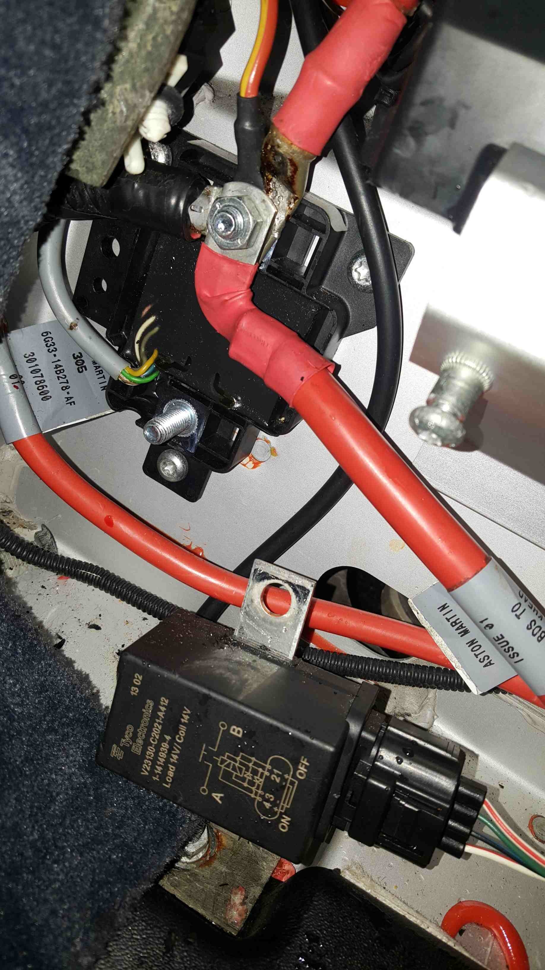

I see ...I'm not talking about the actual button that you press, I'm talking about the battery cut off switch or relay/module..it's the switch that button in your hand controls
under the battery you will see a little black box, almost "t" shaped. There's 1 electrical connector and 3 red cables..1 red on top(along with other smaller gauge wires, need those connected also) and 2 red on the bottom. It's the 2nd picture you posted on this thread. Disconnect your battery, take those red cables off and pair them all together, then reconnect battery.. This bypasses the mechanical/electrical function of any power cut-off

THIS is the BDS being referred to and the associated cables to be jumped.

Thanks for pointing that out. Yes I see now that it wasn't taken out properly. I think I figured out what you mean regarding jumping the switch. I just removed the switch from its place and connected all of the wires together and fastened using a bolt. I just connected them all on the top lug where the switch was initially mounted. Unfortunately, this did not work to start the car. I am also still unable to lock/unlock using the key fob.

Without having the car scanned, really starting to run out of idea's ..what are those water looking drops on the cut off switch connector plug and on the black plastic trim below? ..Battery acid?
At this point you've completely bypass's the BDC, so it looks like the CEM is not allowing the vehicle to start..I don't presently think there's a problem with it but rather just it's disabling a system.
You need to get the car scanned by someone with a AMDS, which is usually the dealer. Those remotes need to get working..and it could very well be you just need all the codes cleared and reset due to a crash status input like AMFixer was mentioning..although what puzzles me is even a crash input status should not stop the remotes from working, hence the reason this car needs to be scanned for all DTC's, problem could be right in front of our eyes with a possible stored DTC
