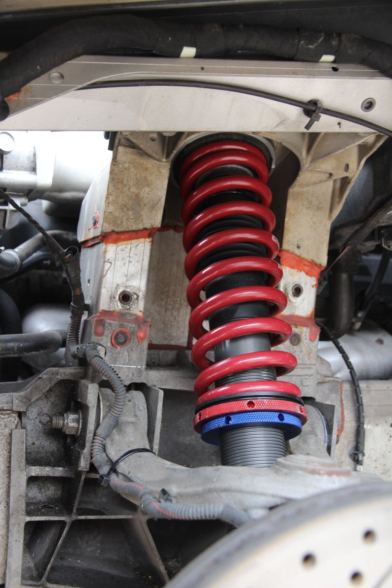

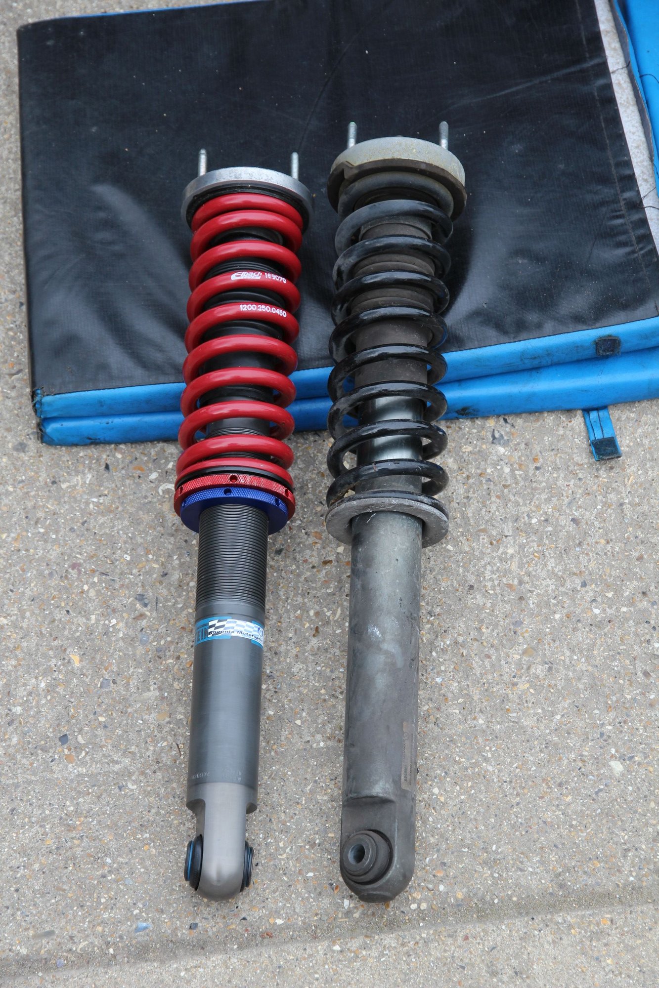

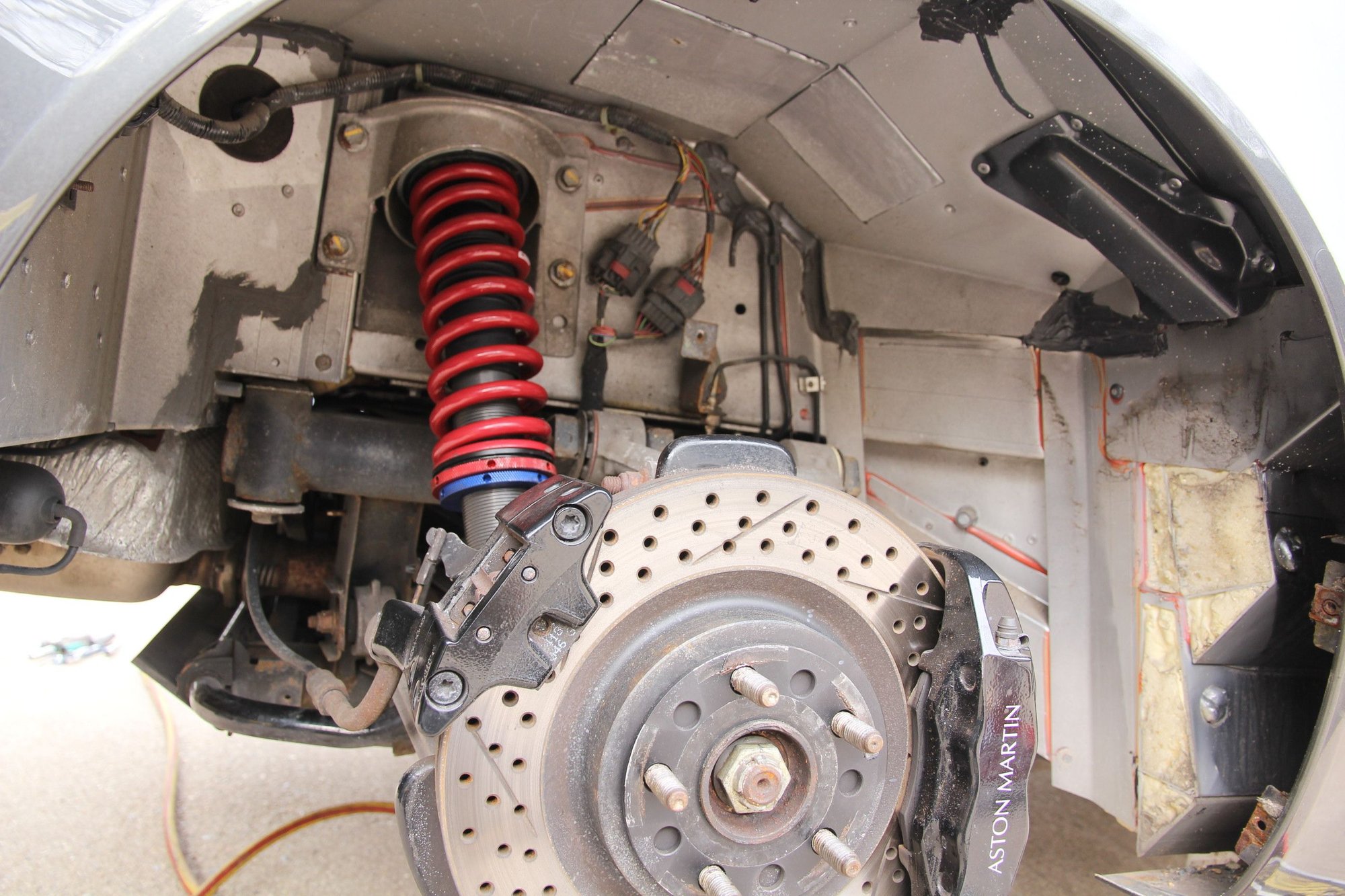

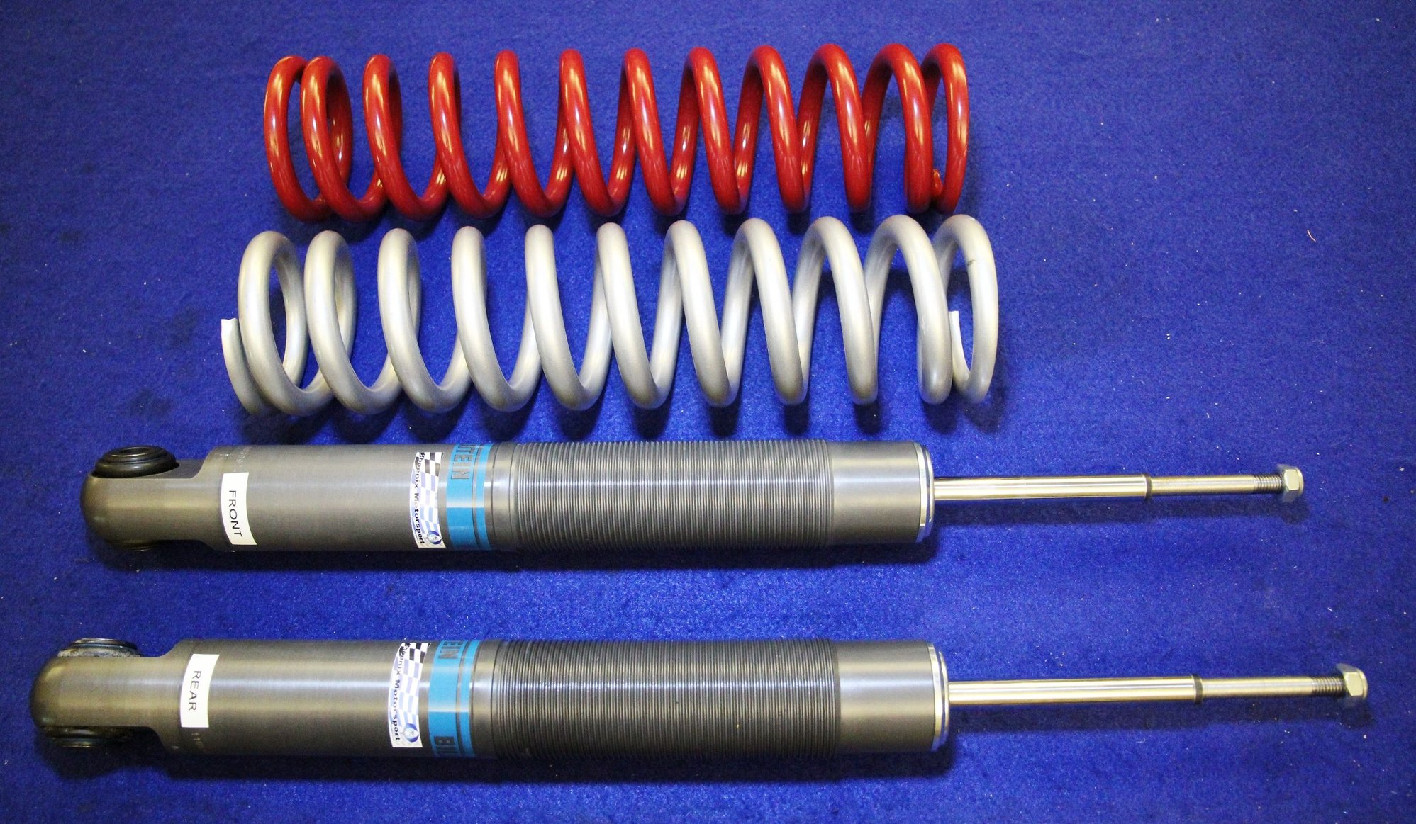

I found that the Euro (UK) spec suspension was WAY too soft on my DB9 Volante and research showed that the suspension on Euro Volante's was set-up for the cruising US market. I have a piece of road local to me where doing 70mph in a negative dip, (not a jump) would bottom the car on a car with perfect suspension, ie, not wear or tear.
I removed the shocks and springs and found the spring rates were around 50% softer than the Euro DBS so I had Eibach supply new springs 25% softer than DBS Sport Pack springs and had Bilstein supply some Extended Vantage coil-overs (DB9/DBS shocks are longer) and reassembled them with needle bearing spring seats and the Eibach springs.
OMG, what a transformation. I went on an Aston Martin factory track day where there were some factory test drivers giving help and education. I asked one to take my car around the track (Brands Hatch) to give advice on some setting-up. He came back and was amazed at the handling of the car and a number of the engineers were all over the car asking what I had done and how. I was thrilled and the only advice was to lower the rear slightly to rebalance the car on its cornering limit.
Car was on stock tyres and a dry track. I think you guys over the pond prefer softer suspension than over here in the UK but this set-up is great for our mediocre UK roads.
