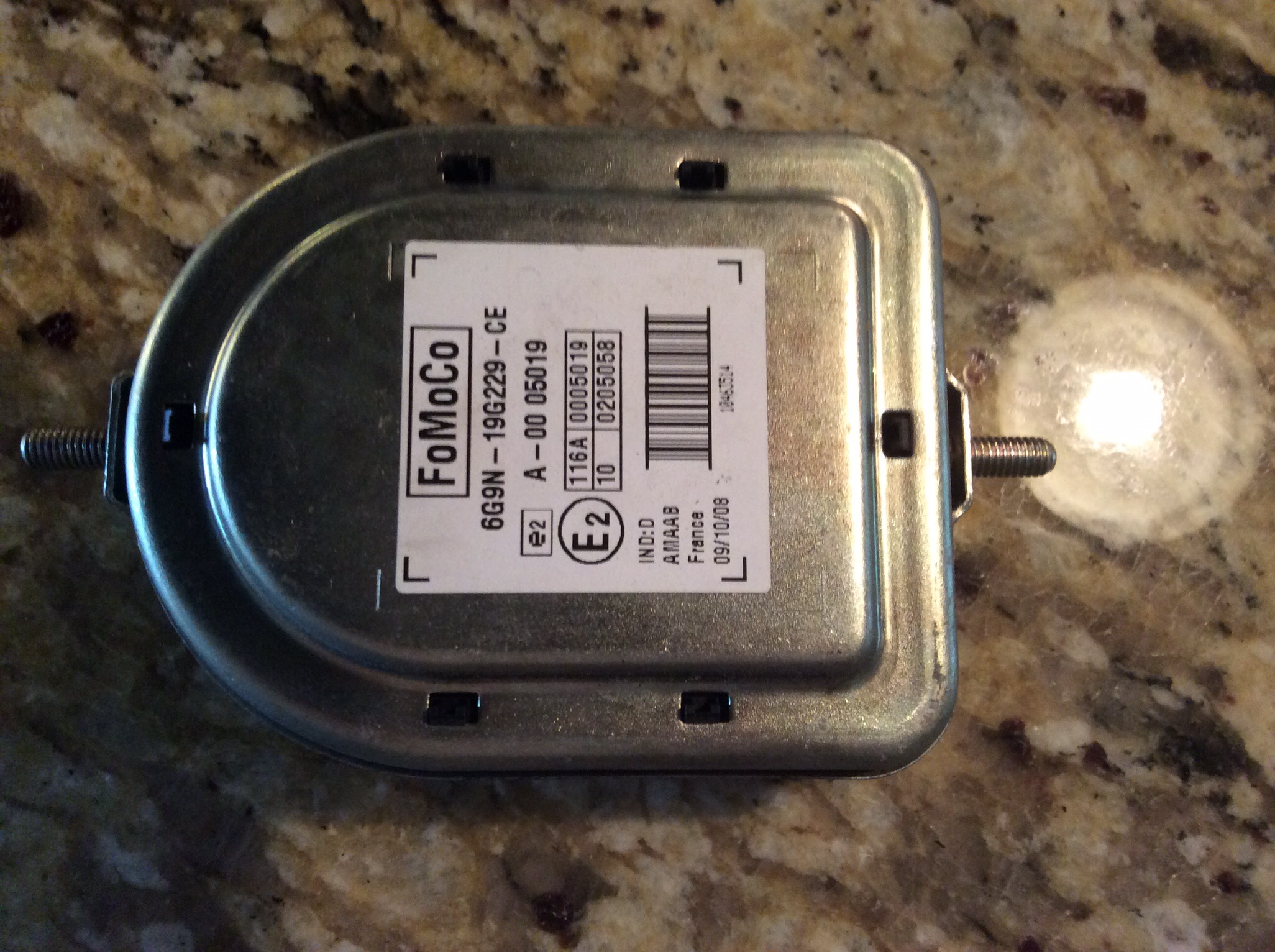

Well I took the part out.
FoMoCo
6G9N-19G229-CE
A-00 05019
Bar code 10463514
I called the Aston dealer the numbers didn't do him any good.
Called the Volvo dealer same thing numbers don't match.
Then called the Ford dealer numbers didn't do them any good.
