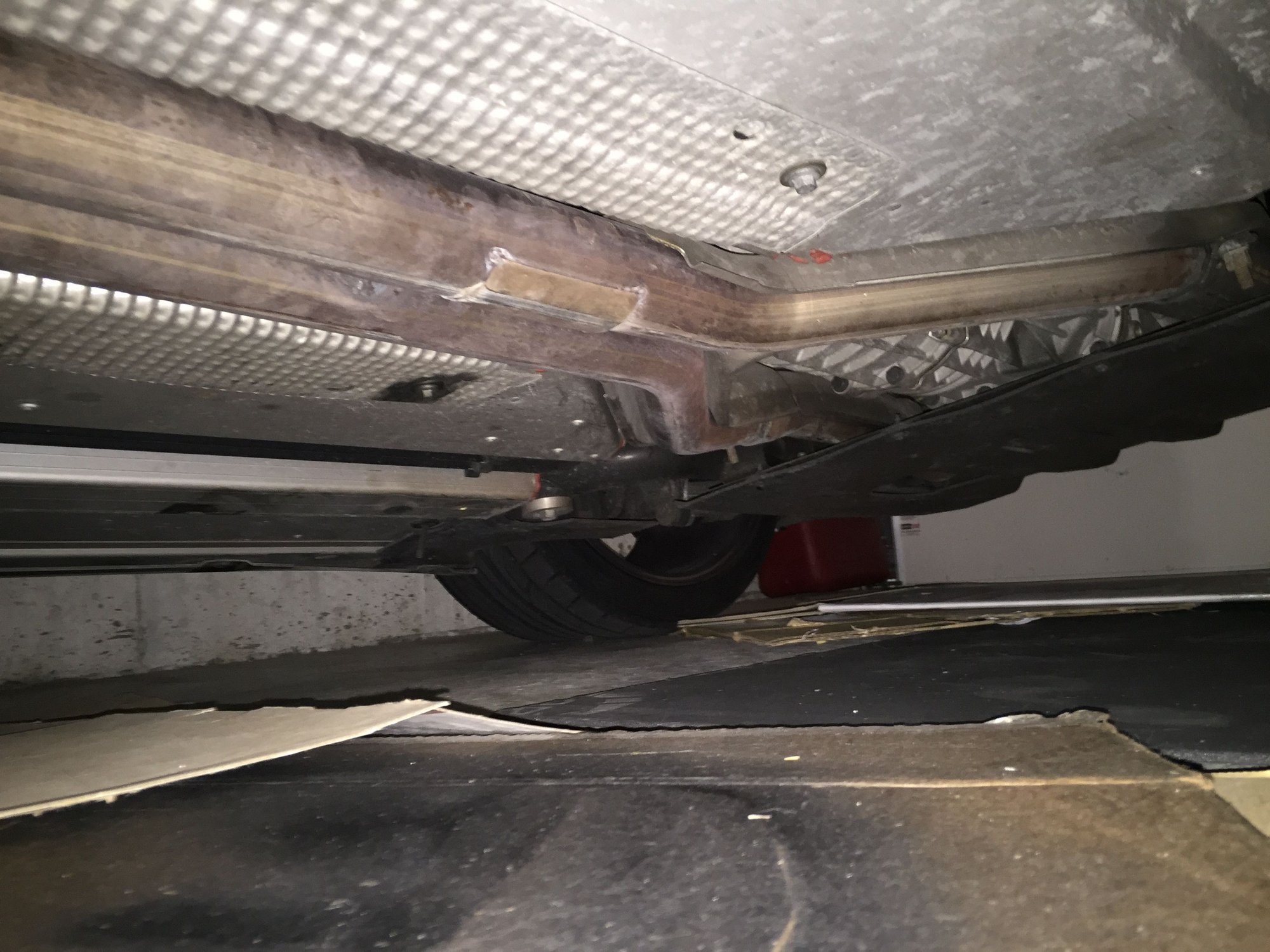

I got my X pipe for the 4.3L Vantage yesterday from Stuart! Very good quality part, shipping was fast and the install went almost without any problems... I found that having the entire exhaust system from the muffler up to the cats loosened, made it go much more smoothly! Plenty of Deep Creep(WD-40) or the like worked wonders and the whole job took me about 2.5 hours with a lunch break! Unfortunately it rained all day so I didnt get any video of the startup nor did I get a chance to drive the car but I will add that as soon as the weather allows. I do have some video of a flybye from before the X Pipe so I am interested to see (hear) the difference!
Package arrived from Velocity!
Old midpipe section
Don't forget to remove this from the old midpipe assembly! You will need it
New X Pipe
All bolted in and tightened down.... Wiaring for some dry roads
