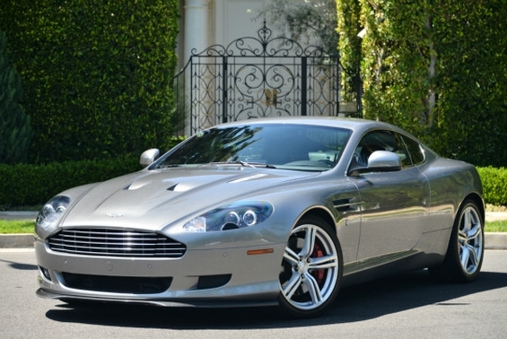

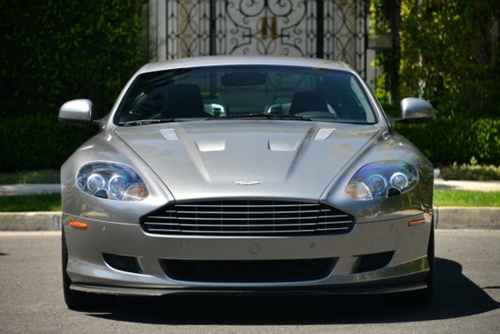

42233935874_405263503_IM1_MAIN_565x421_A_565x378.j pg
2007 DB9. Anyone know this car?

So I've decided to sell the hood in its "as is" condition. Some damage on the leading edge.. Not a big problem to fix. If anyone is interested please Pm me. Thanks for posting the photos of the DB9 with the DBS hood installed.. I think it looks fantastic. Gives the car a little more attitude. Especially with the sport pack wheels.

I to like the look, just wish it was on straight.
