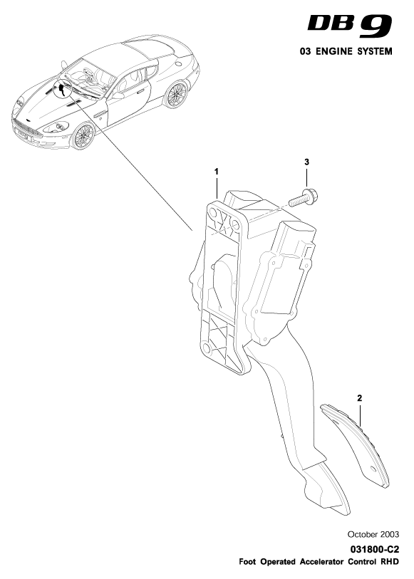

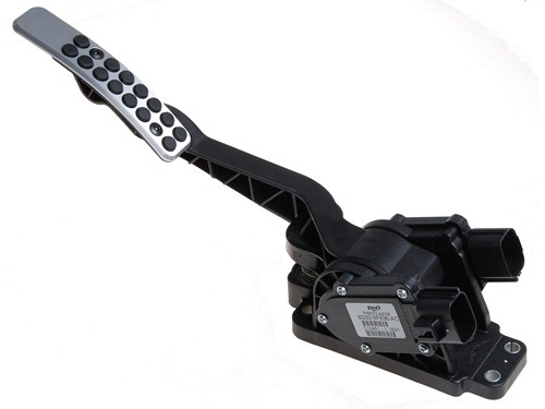

You may have a throttle pedal failure... This happened to my 05 DB9 Manual and the fault codes present were:
P2105, Throttle Actuator Control System - Forced Engine Shutdown
P2106, Throttle Actuator Control system - Forced Limited Power
There are two potentiometers located on either side of the throttle pedal which control the respective left and right bank throttle plate actuators
You need to get a hold of a scanner to be sure. Another way is to remove the intake plenums and have someone view the throttle plates to verify movement while the pedal is depressed with the key in position two. If a second observer is not available a mirror will work.
It may be something else entirely but from my own personal experience a potentiometer seems likely. I replaced the Throttle Pedal Assembly with a servicable unit. Normal function was restored, all fault codes cleared.
