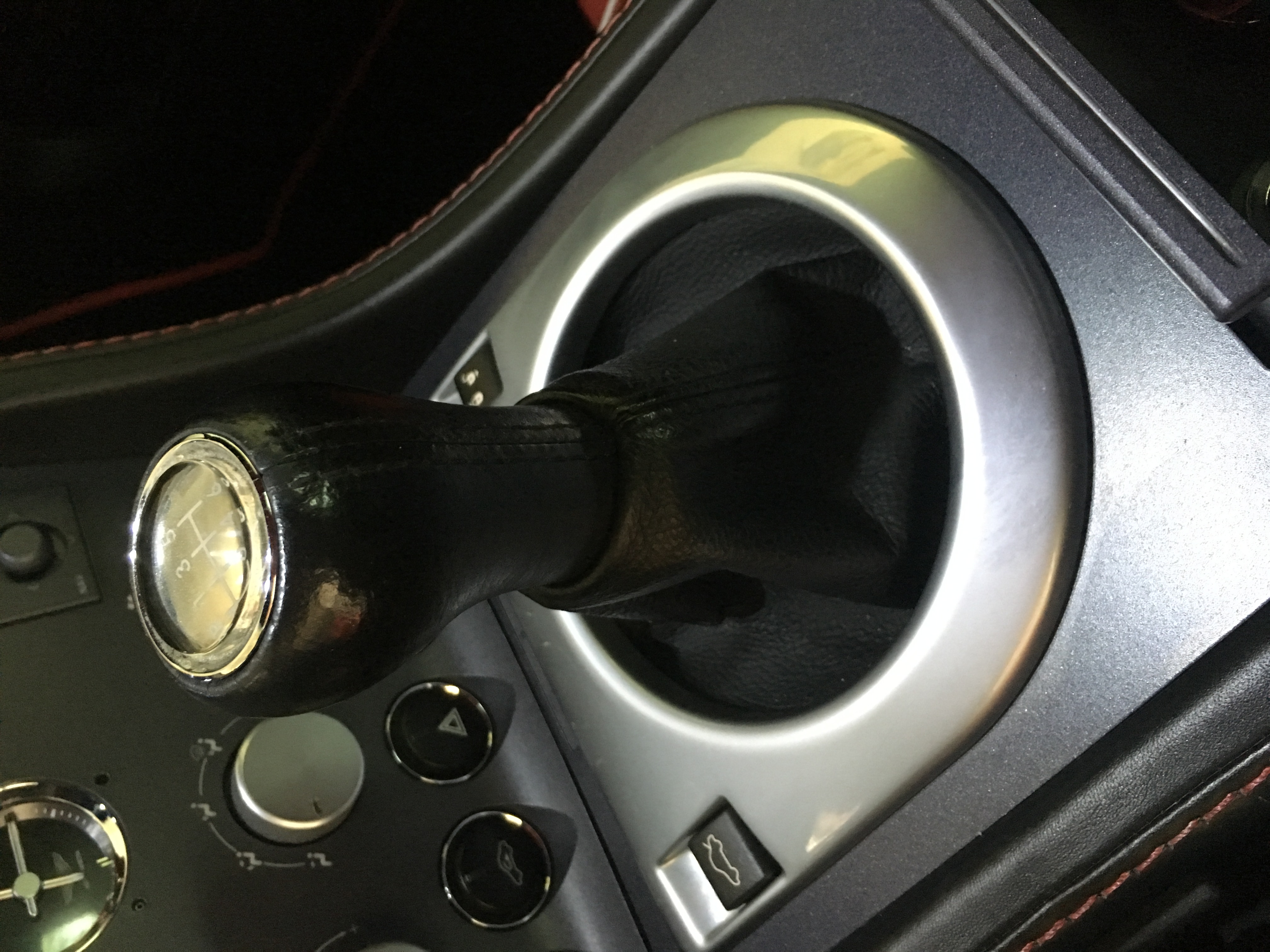

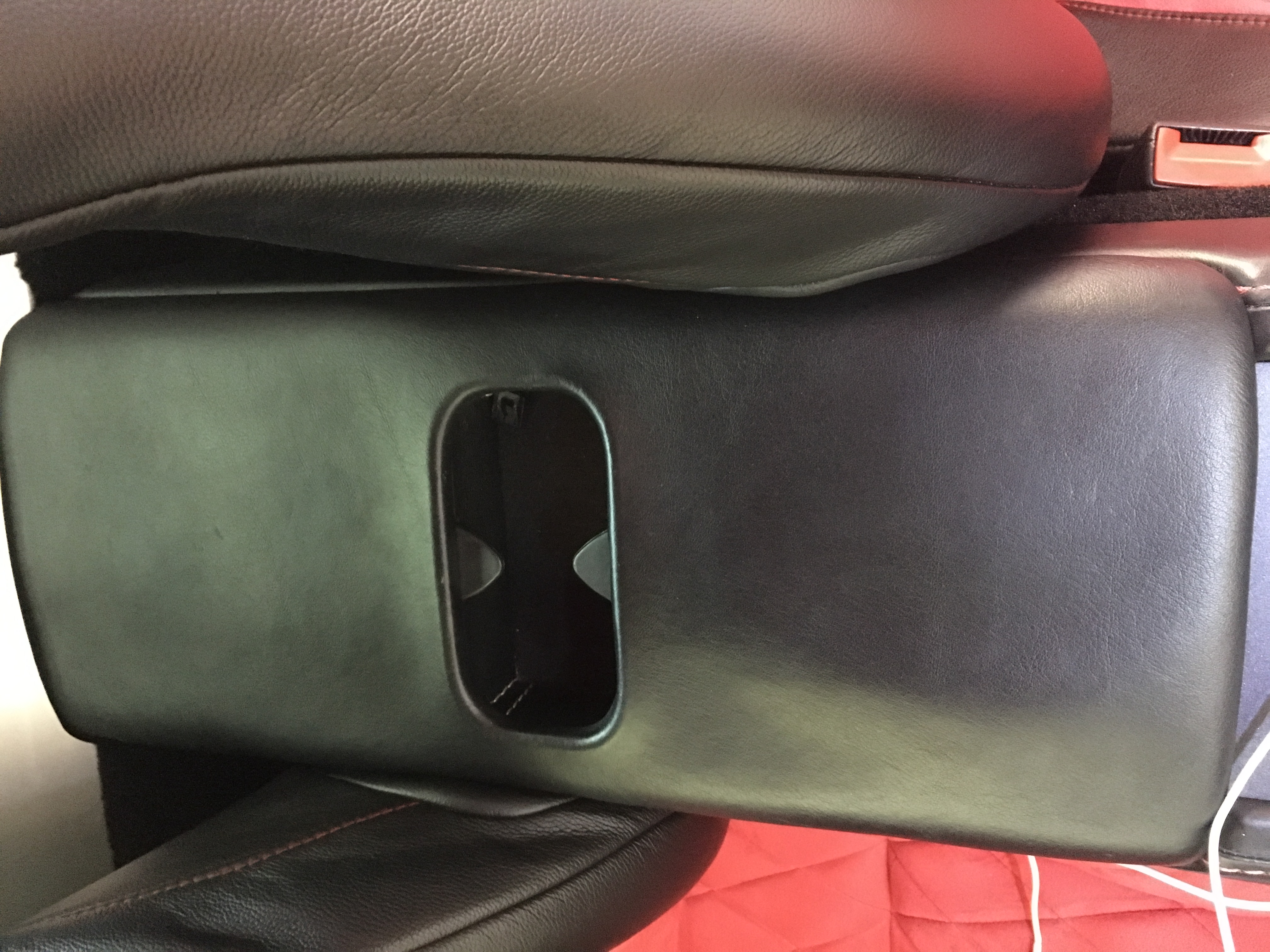

Car is at the shop now so there are all the pics I have. Any instructions would be helpful, I'm trying to help out person doing this as they're a friend.

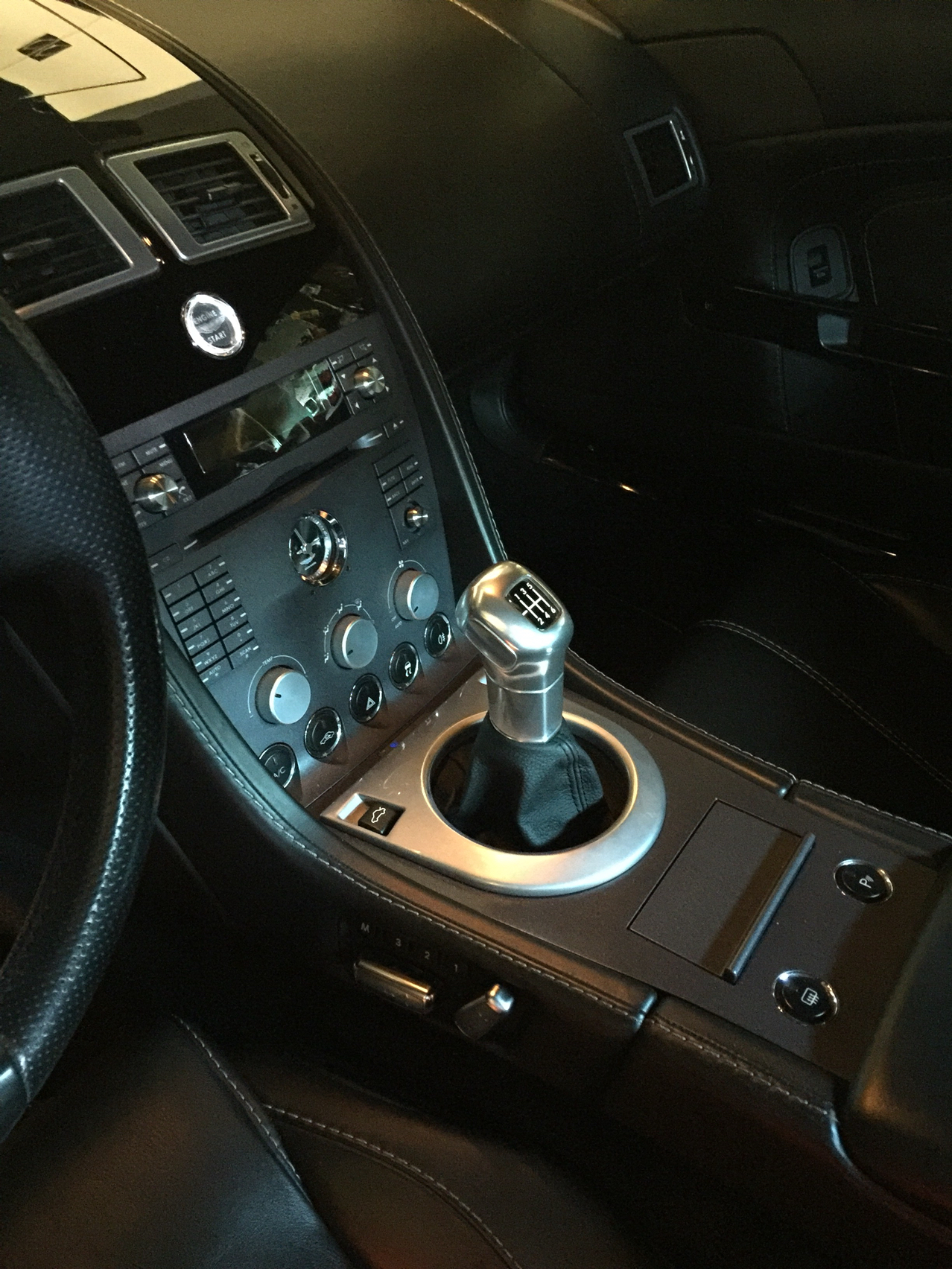

Same here as the others: I installed the DBS **** and I love it! Pretty simple swap.
I followed this thread but was much gentler in execution:
https://www.6speedonline.com/forums/...vantage-2.html

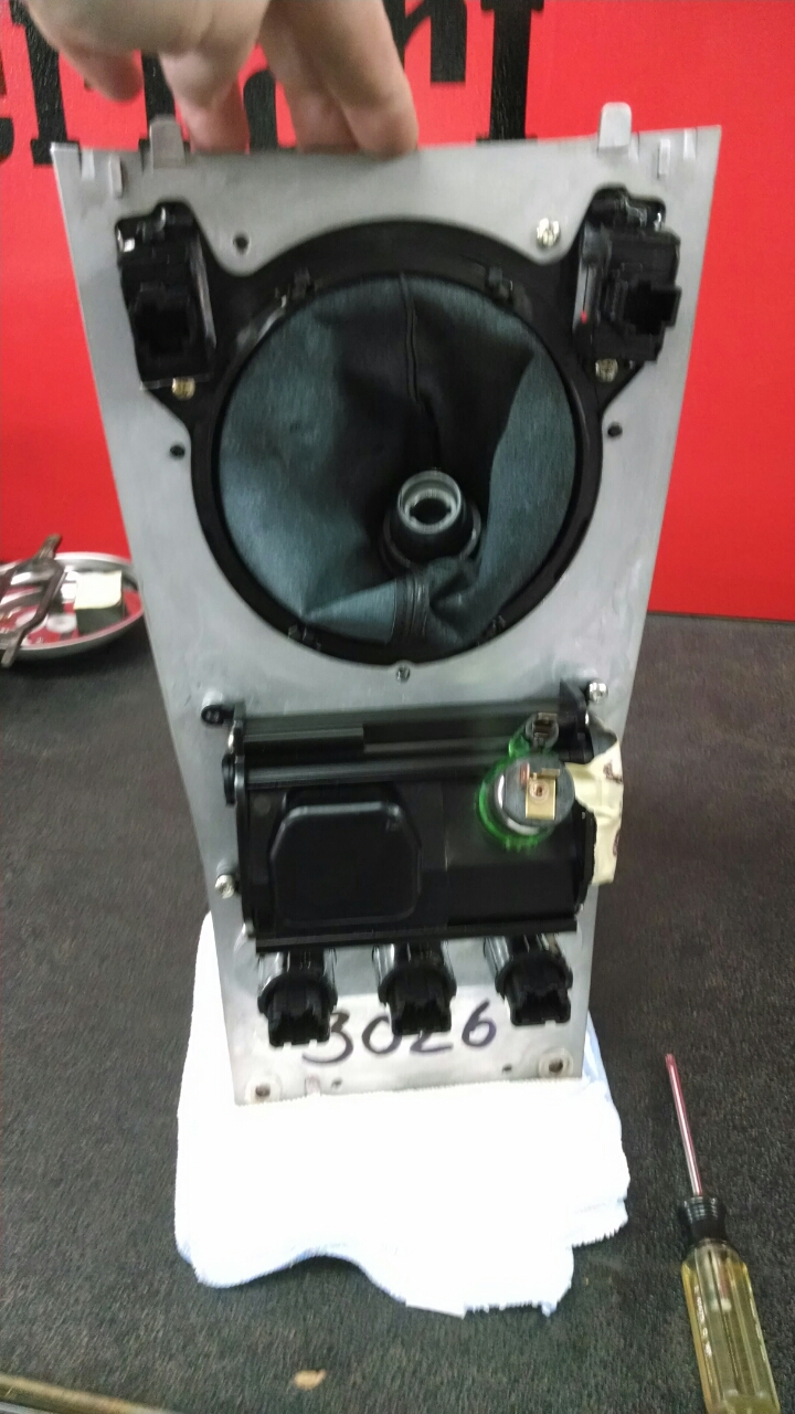

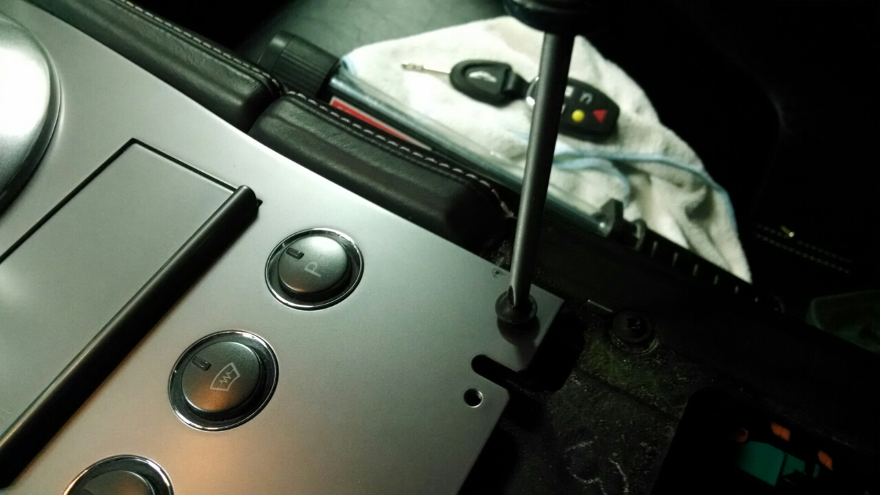

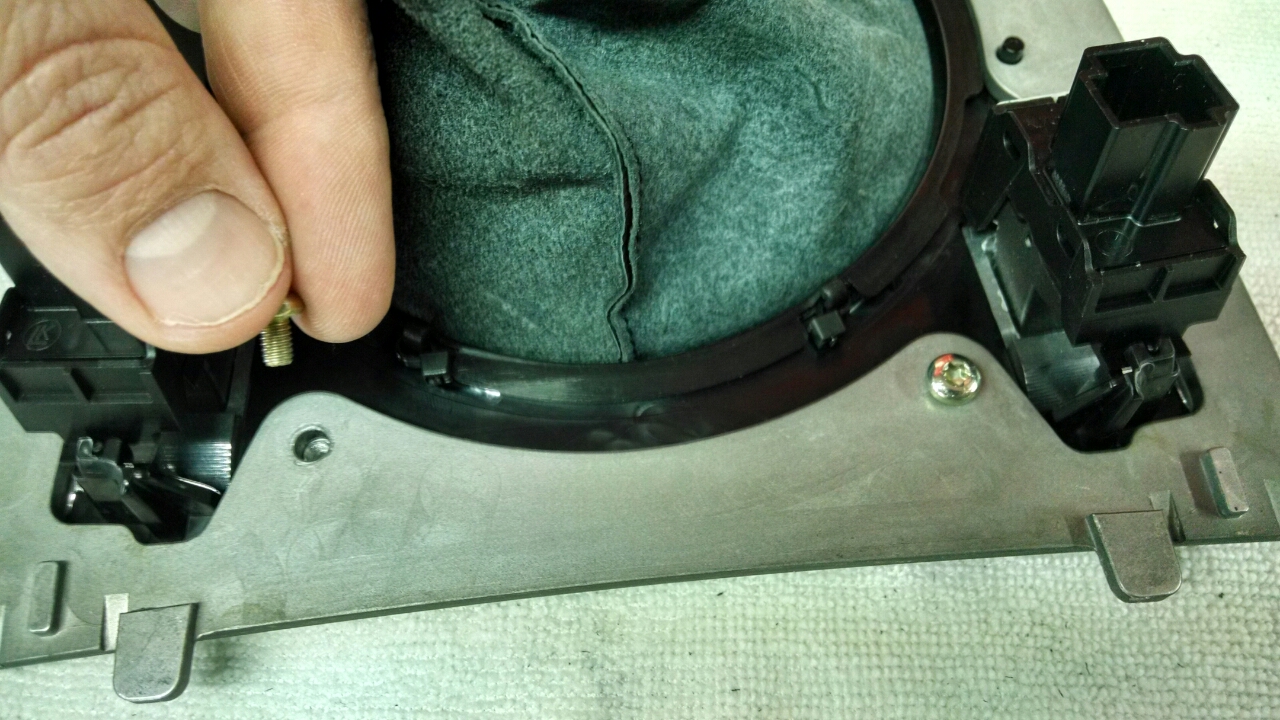

I believe that arm rest just slides backwards with a little bit of encouragement and then there's 2 screws that will b exposed at the bottom of the shifter mounting plate. After removing those, that entire piece will shift rearward also and then after unplugging everything and twisting the **** (push down firmly and turn counter clockwise) loose you'll have the shifter mounting panel out. Then everything becomes vvery obvious.

I think there are some screws at the backside of the armrest. Been a while since I tore mine apart and I don't have my car in front of me to re-check, but going from memory:
1) Remove the parcel shelf.
2) Use a Philips-head screwdriver to remove the several screws on the metal bar that frames the parcel shelf, then remove that bar.
3) Use the screwdriver to remove the screw(s) at the back of the armrest.
4) Push the armrest toward the rear of the car to free it. The leading edge of the armrest has a 'tab' that slides under the trim piece ahead of it.
